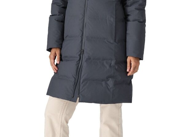

      • Before starting, determine what type of zipper is on the product. See a full list of zipper types here.
      • Two-way zippers (also referred to as dual zippers) have two sliders:
      • One opens the zipper from the top and the other, oriented upside down, opens the zipper from the bottom.
      • Two-way zippers don't have a zipper box.
      • Both coil and plastic tooth (Vislon®) zippers can be two-way.

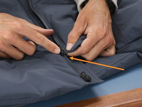

      • To zip correctly:
      • Stack both sliders at the base of the zipper line.
      • Insert the pin from the opposite side through both sliders (top, then bottom).
      • A small "pop" or "click" usually indicates correct placement.
      • You may need to wiggle the sliders if needed to guide the pin through
      • Pull up the top slider to zip the jacket!
