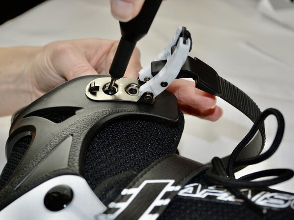

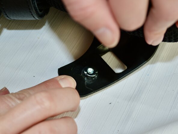

    1. PAPAISON Adjustable Inline Skates Cuff Buckle Replacement With Screws, Cuff Buckle With Screws: step 7, image 1 of 2 PAPAISON Adjustable Inline Skates Cuff Buckle Replacement With Screws, Cuff Buckle With Screws: step 7, image 2 of 2
      • Place the skate on a flat surface.
      • Place the 11 mm washer on the inside of the skate, aligned with the opening.
      Ask FixBot
    2. PAPAISON Adjustable Inline Skates Cuff Buckle Replacement With Screws: step 8, image 1 of 2 PAPAISON Adjustable Inline Skates Cuff Buckle Replacement With Screws: step 8, image 2 of 2
      • Align the cuff buckle on the outside with the corresponding holes.
      Ask FixBot

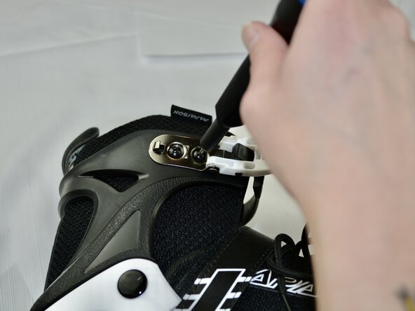

    3. PAPAISON Adjustable Inline Skates Cuff Buckle Replacement With Screws: step 9, image 1 of 2 PAPAISON Adjustable Inline Skates Cuff Buckle Replacement With Screws: step 9, image 2 of 2
      • Insert the 8.5 mm screw into a hole on the outside of the skate.
      • Insert a Phillips #0 screwdriver into the 8.5 mm screw from the outside and turn it until it's tight.
      • Avoid overtightening the screw, as this can make future repairs more difficult.
      Ask FixBot
    4. PAPAISON Adjustable Inline Skates Cuff Buckle Replacement With Screws: step 10, image 1 of 2 PAPAISON Adjustable Inline Skates Cuff Buckle Replacement With Screws: step 10, image 2 of 2
      • Repeat steps 3-5 with second screw.
      Ask FixBot

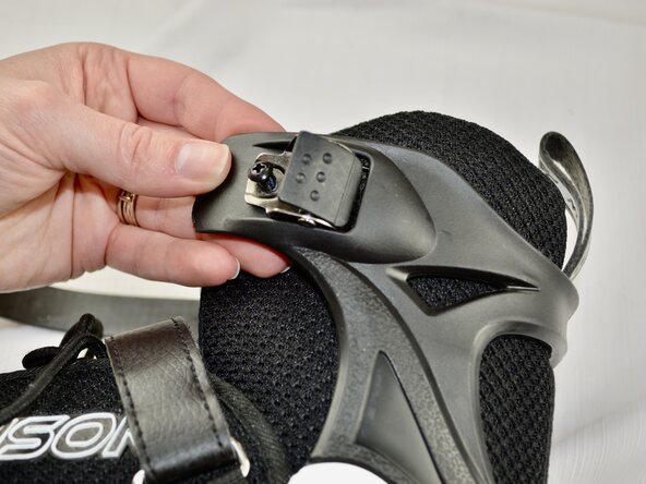

    5. PAPAISON Adjustable Inline Skates Cuff Buckle Replacement With Screws: step 11, image 1 of 1
      • Place a washer over the remaining hole on the outside of the skate buckle.
      Ask FixBot
    6. PAPAISON Adjustable Inline Skates Cuff Buckle Replacement With Screws: step 12, image 1 of 1
      • Align the cuff buckle clip on the exterior of the skate.
      • Ensure the washer is pressed flush with the inside of the skate.
      Ask FixBot
    7. PAPAISON Adjustable Inline Skates Cuff Buckle Replacement With Screws: step 13, image 1 of 3 PAPAISON Adjustable Inline Skates Cuff Buckle Replacement With Screws: step 13, image 2 of 3 PAPAISON Adjustable Inline Skates Cuff Buckle Replacement With Screws: step 13, image 3 of 3
      • Insert the screw into the opening from the outside of the skate.
      • Use a Phillips #0 screwdriver to secure the screw.
      • Your new cuff buckle should now be attached.
