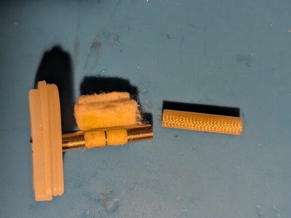

    11. Geek Bar Pulse Mesh Coil Rebuild, Remove the cotton/coil assembly: step 20, image 1 of 1
      • The top end of the metal tube is slotted for removal and insertion of the cotton+coil set.
      Ask FixBot
    12. Geek Bar Pulse Mesh Coil Rebuild: step 21, image 1 of 3 Geek Bar Pulse Mesh Coil Rebuild: step 21, image 2 of 3 Geek Bar Pulse Mesh Coil Rebuild: step 21, image 3 of 3
      • Grasp the cotton firmly and pull it toward the top of the tube to remove it.
      Ask FixBot
    13. Geek Bar Pulse Mesh Coil Rebuild: step 22, image 1 of 2 Geek Bar Pulse Mesh Coil Rebuild: step 22, image 2 of 2
      • The cotton/coil set is free.
      • Here you can see the condition of this assembly in a vape that is well past it's prime; the cotton is burnt and the coils are covered with carbon.
      Ask FixBot
    14. Geek Bar Pulse Mesh Coil Rebuild, Build a new cotton/coil set: step 23, image 1 of 3 Geek Bar Pulse Mesh Coil Rebuild, Build a new cotton/coil set: step 23, image 2 of 3 Geek Bar Pulse Mesh Coil Rebuild, Build a new cotton/coil set: step 23, image 3 of 3
      • Start with an organic cotton face cleansing pad.
      • Cut it into two 15 X 30 mm rectangles.
      • Stack one on top of the other.
      Ask FixBot
    15. Geek Bar Pulse Mesh Coil Rebuild: step 24, image 1 of 3 Geek Bar Pulse Mesh Coil Rebuild: step 24, image 2 of 3 Geek Bar Pulse Mesh Coil Rebuild: step 24, image 3 of 3
      • Lay the replacement coil down on the cotton with the two wires closest to you, centered on the cotton pad.
      • (Optional) In order to reduce the time needed for your ejuice to soak the cotton, squirt a line of juice over the area covered by the mesh.
      • For this step you'll need a solid dowel of some sort to wrap the assembly around. This forms the coil and leaves an airspace in the center of the assembly. The shaft should be somewhere between 2 and 3 mm in diameter; in this case I used an iFixit Standoff Screwdriver, which measures at 2.5 mm.
      • If you use a dowel that's on the small side, double check to ensure that the two edges of the mesh do not touch when they're wrapped around it. If they do, the mesh won't heat, as the resistance will be wrong.
      • Wrap the cotton tightly around the shaft and hold it in place.
      Ask FixBot
    16. Geek Bar Pulse Mesh Coil Rebuild, Insert the coil/cotton into the metal tube: step 25, image 1 of 3 Geek Bar Pulse Mesh Coil Rebuild, Insert the coil/cotton into the metal tube: step 25, image 2 of 3 Geek Bar Pulse Mesh Coil Rebuild, Insert the coil/cotton into the metal tube: step 25, image 3 of 3
      • Carefully fit the end of the assembly into the end of the tube with the opening slot.
      • Be sure all three wires feed out the opposite end of the tube.
      • Slide the cotton into the tube; you may have to compress the cotton to get it started.
      • Continue inserting the cotton until it bottoms out firmly at the end of the slot.
      • Make sure there's still cotton visible at the top of the opening on the side; if there's a gap, slide the cotton up slightly to eliminate the gap.
      Ask FixBot
