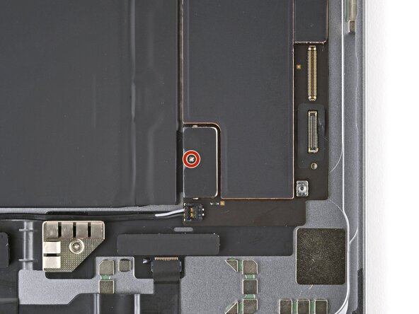

    1. iPad Air 6 11" Battery Replacement, Remove the battery connector screw: step 22, image 1 of 2 iPad Air 6 11" Battery Replacement, Remove the battery connector screw: step 22, image 2 of 2
      • Use a JIS 00 screwdriver to remove the 1.8 mm‑long screw securing the battery connector.

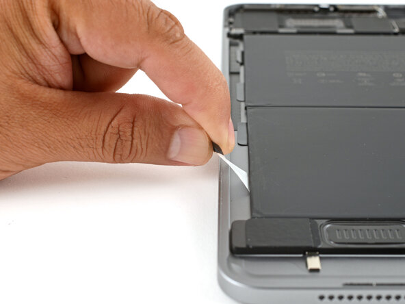

    3. iPad Air 6 11" Battery Replacement, Remove the stretch-release adhesives: step 24, image 1 of 3 iPad Air 6 11" Battery Replacement, Remove the stretch-release adhesives: step 24, image 2 of 3 iPad Air 6 11" Battery Replacement, Remove the stretch-release adhesives: step 24, image 3 of 3
      • Firmly grab a pull tab with your fingers.
      • Slowly pull the strips straight away from the battery, keeping a low angle to the frame.
      • Give the strips plenty of time to stretch. If a strip breaks off, try to retrieve it and continue pulling.
      • Repeat the procedure to remove all four stretch-release adhesive strips.
      • If you removed all four stretch-release adhesive strips, skip down five steps.
      • If any strips broke off, follow the next three steps to remove the adhesive remnants.

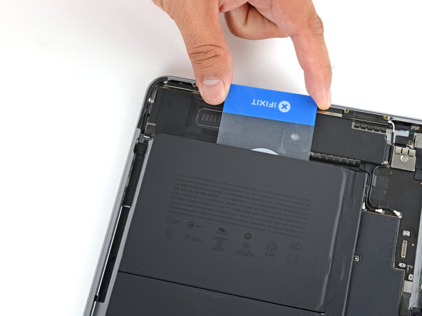

    5. iPad Air 6 11" Battery Replacement: step 26, image 1 of 3 iPad Air 6 11" Battery Replacement: step 26, image 2 of 3 iPad Air 6 11" Battery Replacement: step 26, image 3 of 3
      Tool used on this step:
      Plastic Cards
      $2.99
      Buy
      • Slide a plastic card under the left edge of the upper battery cell near any broken strips of stretch-release adhesive.
      • Don't puncture or bend the battery. If it feels stuck, apply more isopropyl alcohol to help soften the adhesive.
      • Slide the plastic card under the top edge to separate any remaining stretch-release adhesives.
      Ask FixBot

    8. iPad Air 6 11" Battery Replacement: step 29, image 1 of 3 iPad Air 6 11" Battery Replacement: step 29, image 2 of 3 iPad Air 6 11" Battery Replacement: step 29, image 3 of 3
      • Insert an opening pick under the top-right corner of the battery.
      • If it feels difficult, apply a few more drops of isopropyl alcohol and try again.
      • Remove the opening pick and insert a plastic card under the top-right corner to separate the top-right adhesive.
      Ask FixBot
    9. iPad Air 6 11" Battery Replacement: step 30, image 1 of 2 iPad Air 6 11" Battery Replacement: step 30, image 2 of 2
      • Insert an opening pick under the bottom-right corner of the battery to separate the battery connector adhesive.
      • Be sure to insert the pick completely under the battery and not through its side.
      • Leave the opening pick in place to prevent the adhesive from re-adhering.

    10. iPad Air 6 11" Battery Replacement, Remove the battery: step 31, image 1 of 3 iPad Air 6 11" Battery Replacement, Remove the battery: step 31, image 2 of 3 iPad Air 6 11" Battery Replacement, Remove the battery: step 31, image 3 of 3
      • Grab and pull the battery away from the logic board until the battery connector slides out from under the logic board.
      • If the battery connector feels stuck, apply a few drops of isopropyl alcohol under the connector and try again.
      • Remove the battery.
