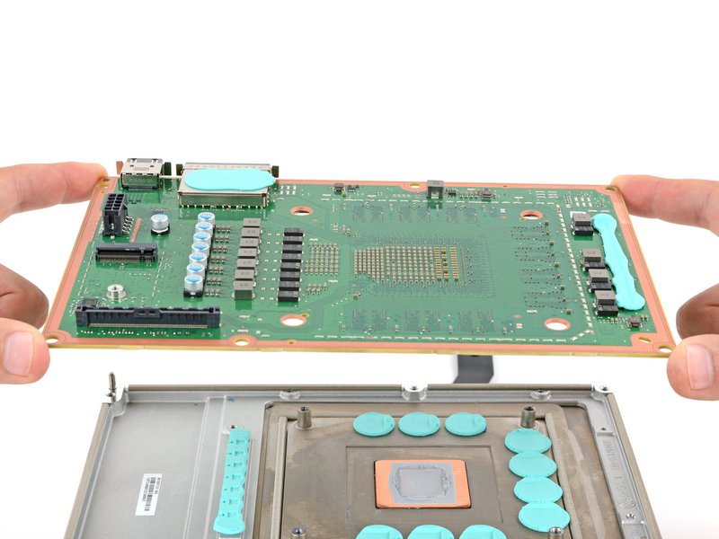

    5. Xbox Series X (Digital Edition) Motherboard Replacement, Remove the board shield: step 29, image 1 of 2 Xbox Series X (Digital Edition) Motherboard Replacement, Remove the board shield: step 29, image 2 of 2
      • Use a T8 Torx driver to remove the ten screws securing the board shield:
      • Seven 8.7 mm‑long screws
      • Two 35 mm‑long screws
      • These screws are very tight and may take significant force to loosen.
      • One 13 mm‑long screw
      Ask FixBot
    6. Xbox Series X (Digital Edition) Motherboard Replacement: step 30, image 1 of 3 Xbox Series X (Digital Edition) Motherboard Replacement: step 30, image 2 of 3 Xbox Series X (Digital Edition) Motherboard Replacement: step 30, image 3 of 3
      • Hold the power supply cable out of the way and lift the board shield straight up to remove it.
      Ask FixBot
    1. Xbox Series X (Digital Edition) Motherboard Replacement, Disconnect the power supply cables: step 31, image 1 of 3 Xbox Series X (Digital Edition) Motherboard Replacement, Disconnect the power supply cables: step 31, image 2 of 3 Xbox Series X (Digital Edition) Motherboard Replacement, Disconnect the power supply cables: step 31, image 3 of 3
      • Open the lid on the power supply's plastic cable guide.
      Ask FixBot
    2. Xbox Series X (Digital Edition) Motherboard Replacement: step 32, image 1 of 3 Xbox Series X (Digital Edition) Motherboard Replacement: step 32, image 2 of 3 Xbox Series X (Digital Edition) Motherboard Replacement: step 32, image 3 of 3
      • Always pull cables by their connectors and not the wires themselves.
      • Use your fingers to pinch the power supply's 10‑pin power connector, so the locking tab opens outward.
      • With the locking tab open, lift the connector straight up and out of its socket.

    4. Xbox Series X (Digital Edition) Motherboard Replacement, Remove the motherboard: step 44, image 1 of 3 Xbox Series X (Digital Edition) Motherboard Replacement, Remove the motherboard: step 44, image 2 of 3 Xbox Series X (Digital Edition) Motherboard Replacement, Remove the motherboard: step 44, image 3 of 3
      • Depending on the condition of the thermal paste and putty, the board may be bonded to the heatsink assembly. If you can't easily remove the board, use a spudger to gently lift the edges of the board to separate it.
      • Use your fingers to lift the motherboard straight up and off the heatsink to remove it.
      • During reassembly, carefully place the board onto the heatsink with the APU facing down. Remember, there's exposed thermal paste on the bottom of the board, so use the alignment pegs to orient it correctly. If you have to reposition the board, it may smear the thermal paste.
      Ask FixBot
    5. Xbox Series X (Digital Edition) Motherboard Replacement, Replace the thermal pads: step 45, image 1 of 2 Xbox Series X (Digital Edition) Motherboard Replacement, Replace the thermal pads: step 45, image 2 of 2
      • Check the condition of the thermal putty—it'll be on the heatsink and/or the motherboard.
      • If any pieces are damaged or dried out, follow the next four steps to remove and replace them.
      • If you're only replacing the thermal paste, skip to this step.
