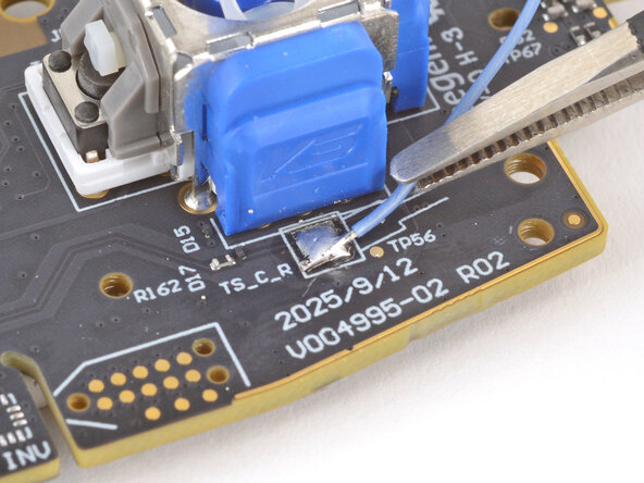

    2. Steam Controller (2nd Generation) Thumbstick Covers Replacement, Remove the protective coatings: step 15, image 1 of 3 Steam Controller (2nd Generation) Thumbstick Covers Replacement, Remove the protective coatings: step 15, image 2 of 3 Steam Controller (2nd Generation) Thumbstick Covers Replacement, Remove the protective coatings: step 15, image 3 of 3
      • The solder joints for the capacitive touch wires are both covered with a dab of clear, protective glue.
      • Use a heat gun or hair dryer to heat each pad until it becomes soft.
      • For tips and warnings on heat gun use, check out this guide. For best practices when using a hair dryer, check out this guide.
      • If you're using a heat gun, hold it at least 4–5 inches (10–12 cm) away from the board and apply heat for only for short periods of time to avoid melting the plastic components on the thumbstick modules.
      • Use pointed tweezers to slowly peel up and remove both dabs of glue.
      Ask FixBot
    3. Steam Controller (2nd Generation) Thumbstick Covers Replacement, Desolder the capacitive touch wires: step 16, image 1 of 3 Steam Controller (2nd Generation) Thumbstick Covers Replacement, Desolder the capacitive touch wires: step 16, image 2 of 3 Steam Controller (2nd Generation) Thumbstick Covers Replacement, Desolder the capacitive touch wires: step 16, image 3 of 3
      • If you're new to soldering, check out our guide on desoldering and soldering connections for helpful tips and tricks.
      • If your soldering iron has a temperature setting, set it to 350 °C (~650 °F).
      • Use tweezers to grip one of the capacitive touch wires close to its solder connection.
      • Press the tip of your iron against the solder connection until it melts, then lift the wire away with the tweezers.
      • Be careful not to touch the adjacent plastic cover on the thumbstick module with your iron.
      Ask FixBot
    4. Steam Controller (2nd Generation) Thumbstick Covers Replacement: step 17, image 1 of 2 Steam Controller (2nd Generation) Thumbstick Covers Replacement: step 17, image 2 of 2
      • Repeat to desolder the second capacitive touch wire.
      Ask FixBot
    5. Steam Controller (2nd Generation) Thumbstick Covers Replacement, Solder the capacitive touch wires: step 18, image 1 of 2 Steam Controller (2nd Generation) Thumbstick Covers Replacement, Solder the capacitive touch wires: step 18, image 2 of 2
      • Heat the pad with your iron and feed a small amount of solder onto the pad to form a bead.
      Ask FixBot
    6. Steam Controller (2nd Generation) Thumbstick Covers Replacement: step 19, image 1 of 3 Steam Controller (2nd Generation) Thumbstick Covers Replacement: step 19, image 2 of 3 Steam Controller (2nd Generation) Thumbstick Covers Replacement: step 19, image 3 of 3
      • Use tweezers to hold the replacement thumbstick cover's capacitive touch wire on the solder bead, so the wire is facing the direction shown in the diagram on the board.
      • Press the tip of your iron onto the bead until it melts, making sure the wire gets covered with solder for a solid connection.
      • Repeat the last two steps to solder the second capacitive touch wire.
      Ask FixBot
