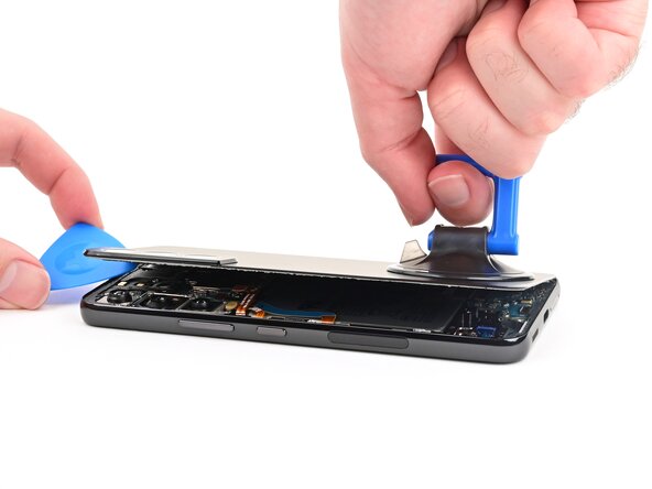

    8. Samsung Galaxy S22 Screen Replacement, Apply a suction handle: step 25, image 1 of 2 Samsung Galaxy S22 Screen Replacement, Apply a suction handle: step 25, image 2 of 2
      • Apply a suction handle to the center of the screen's bottom edge, as close to the edge as possible.
      Ask FixBot
    9. Samsung Galaxy S22 Screen Replacement, Insert an iFlex: step 26, image 1 of 3 Samsung Galaxy S22 Screen Replacement, Insert an iFlex: step 26, image 2 of 3 Samsung Galaxy S22 Screen Replacement, Insert an iFlex: step 26, image 3 of 3
      • Be careful not to scratch the frame of the phone with the iFlex in this step.
      • Lift the suction handle with strong, steady force.
      • Insert an iFlex in the gap between the bottom edge of the screen and the frame.
      Ask FixBot
    10. Samsung Galaxy S22 Screen Replacement, Insert an opening pick: step 27, image 1 of 3 Samsung Galaxy S22 Screen Replacement, Insert an opening pick: step 27, image 2 of 3 Samsung Galaxy S22 Screen Replacement, Insert an opening pick: step 27, image 3 of 3
      • Replace the iFlex with an opening pick.
      • Slide the opening pick around the top left corner of the phone, separating the glass from the display itself.
      Ask FixBot

    12. Samsung Galaxy S22 Screen Replacement, Separate the bottom edge adhesive: step 29, image 1 of 3 Samsung Galaxy S22 Screen Replacement, Separate the bottom edge adhesive: step 29, image 2 of 3 Samsung Galaxy S22 Screen Replacement, Separate the bottom edge adhesive: step 29, image 3 of 3
      • Slide the opening pick back and forth across the bottom edge of the phone to separate the adhesive securing the screen to the frame.
      • Leave the opening pick in the bottom‑left corner of the phone to keep the adhesive separated.
      Ask FixBot

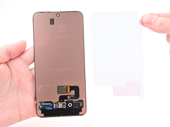

    19. Samsung Galaxy S22 Screen Replacement, Lift the screen: step 36, image 1 of 3 Samsung Galaxy S22 Screen Replacement, Lift the screen: step 36, image 2 of 3 Samsung Galaxy S22 Screen Replacement, Lift the screen: step 36, image 3 of 3
      • The screen should be free at this point. If the screen is still adhered anywhere, use heat and an opening pick to separate the adhesive.
      • Use the opening pick to lift the screen until you can grab it with your fingers.
      Ask FixBot
    20. Samsung Galaxy S22 Screen Replacement, Remove the screen: step 37, image 1 of 2 Samsung Galaxy S22 Screen Replacement, Remove the screen: step 37, image 2 of 2
      • Lift the screen off the frame and remove it.
      Ask FixBot

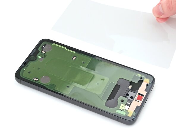

    21. Samsung Galaxy S22 Screen Replacement, Clean the frame: step 38, image 1 of 2 Samsung Galaxy S22 Screen Replacement, Clean the frame: step 38, image 2 of 2
      • Before installing adhesive, all the old adhesive must be completely removed from the frame.
      • Take your time during the next few steps. A clean frame allows replacement adhesive to lay totally flat, ensuring a better seal for your new screen.
      • The graphite sheet attached to the frame is very fragile. Be careful not to damage it when cleaning the frame.
      Ask FixBot
    22. Samsung Galaxy S22 Screen Replacement, Lift the adhesive: step 39, image 1 of 2 Samsung Galaxy S22 Screen Replacement, Lift the adhesive: step 39, image 2 of 2
      • Use the flat end of a spudger to lift a piece of adhesive residue off the frame, just enough to grab it with a pair of blunt tweezers.

    28. Samsung Galaxy S22 Screen Replacement, Align the large adhesive: step 45, image 1 of 3 Samsung Galaxy S22 Screen Replacement, Align the large adhesive: step 45, image 2 of 3 Samsung Galaxy S22 Screen Replacement, Align the large adhesive: step 45, image 3 of 3
      • Hold the large adhesive above the frame to find its orientation. Use cutouts in the liner and the contours of the adhesive to help visualize how it will lay in the frame.
      • Keep the adhesive in this orientation in the next few steps.

    36. Samsung Galaxy S22 Screen Replacement, Prepare the replacement screen: step 53, image 1 of 3 Samsung Galaxy S22 Screen Replacement, Prepare the replacement screen: step 53, image 2 of 3 Samsung Galaxy S22 Screen Replacement, Prepare the replacement screen: step 53, image 3 of 3
      • Your replacement screen may have protective liners on the underside that must be removed before installation. Usually, you can identify the liners by their pull tabs.
      • The exposed back of the screen is very fragile—even a small scratch can cause damage. Be very careful not to damage the screen during the remaining steps.
      • Use your fingers or tweezers to remove all plastic liners from the back of the replacement screen.

    40. Samsung Galaxy S22 Screen Replacement, Remove the back cover: step 57, image 1 of 3 Samsung Galaxy S22 Screen Replacement, Remove the back cover: step 57, image 2 of 3 Samsung Galaxy S22 Screen Replacement, Remove the back cover: step 57, image 3 of 3
      • Flip the phone over.
      • Work slowly when removing the back cover—the adhesive isn't as strong as before. If you feel resistance when lifting, apply heat instead of using more force.
      • Use a suction handle to gently lift the back cover from its bottom edge. If it won't lift easily, use an iOpener, hair dryer, or heat gun to heat it until it's hot to the touch.
      • Use an opening pick to gently separate the adhesive securing the back cover.
      • Lift and remove the back cover.
