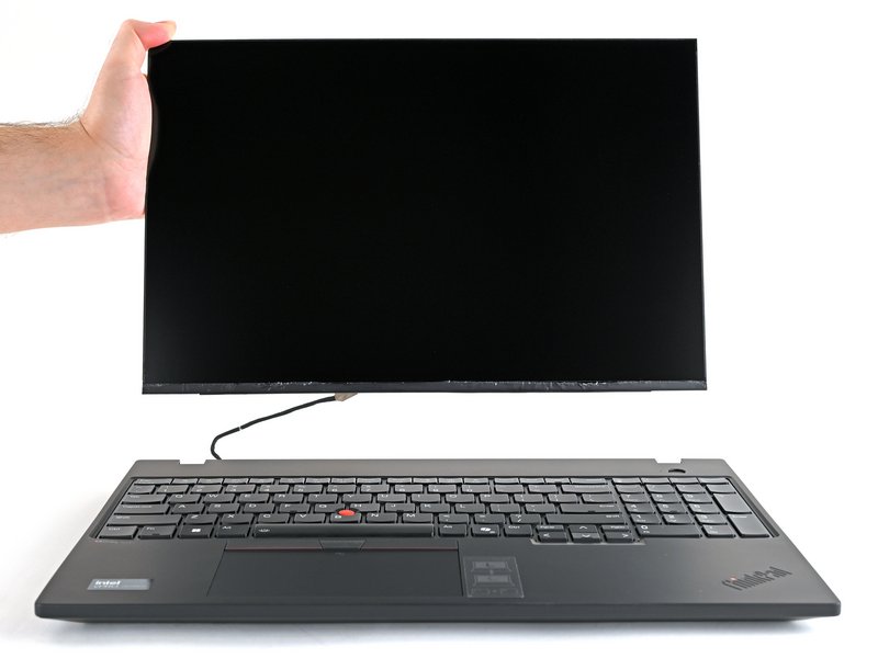

Lenovo ThinkPad T16 Gen 3 Display Replacement
Introduction
Go to step 1 ↓
Follow this guide to upgrade or replace a broken or cracked display (aka LCD or OLED) on your Lenovo ThinkPad T16 Gen 3 laptop.
This guide is for the display on its own. If you have an entire screen assembly (including a new top lid, hinges, bezel, and display) follow this guide.

    4. Lenovo ThinkPad T16 Gen 3 Display Replacement, Remove the display: step 33, image 1 of 3 Lenovo ThinkPad T16 Gen 3 Display Replacement, Remove the display: step 33, image 2 of 3 Lenovo ThinkPad T16 Gen 3 Display Replacement, Remove the display: step 33, image 3 of 3
      • Remove the display from the lid.
      Ask FixBot

    18. Lenovo ThinkPad T16 Gen 3 Display Replacement, Install the new display: step 47, image 1 of 3 Lenovo ThinkPad T16 Gen 3 Display Replacement, Install the new display: step 47, image 2 of 3 Lenovo ThinkPad T16 Gen 3 Display Replacement, Install the new display: step 47, image 3 of 3
      • Align your replacement display with the laptop.
      • Place the top edge down first, ensuring it is centered. You may have to wiggle it before it settles into place.
      • Lay the display down fully.
      • Double-check the display is centered. If it isn't, the bezel will not attach properly.
      • To complete reassembly, follow the steps in reverse order, beginning with Step 29.
