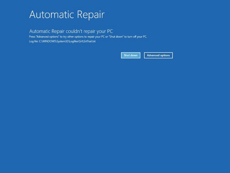

Is your PC running slow for "no reason?" Is it exhibiting some weird behavior, that's hard to describe? Are some Windows elements not functioning or crashing? These all point to corruption of the Windows Operating System. Corruption can even cause failure to boot altogether.
Fixing this is less about hardware, and more about tinkering in command line. We promise it isn't as scary as you think. But be aware this kind of thing isn't for everyone.
    1. How to Perform Basic Windows Repair, Open a Command Line Session: step 1, image 1 of 1
      • Right click the start menu (or press Win and X on your keyboard).
      • In the menu that appears, open the command line tool it offers here. It may be Command, PowerShell or Terminal depending on your settings and version of Windows.
      • Be sure to open as Admin. You'll need your Admin powers to make run the needed repairs.
      • If your computer doesn't boot to Windows, most commands can also be used within Windows Recovery Environment.
