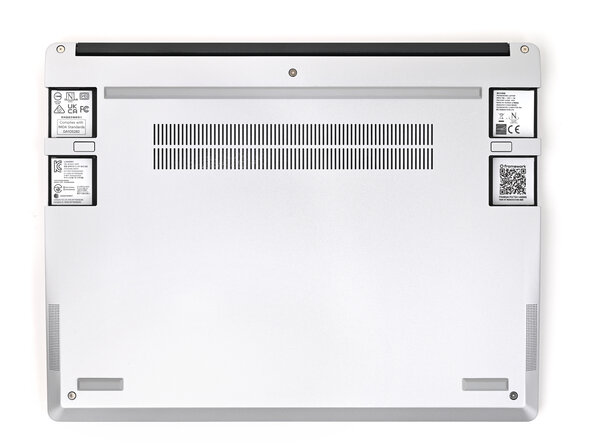

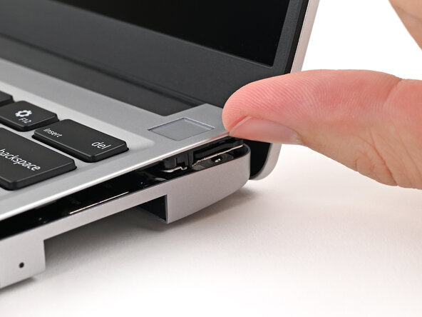

    1. Framework Laptop 13 Mainboard Replacement, Remove the Expansion Cards: step 2, image 1 of 2 Framework Laptop 13 Mainboard Replacement, Remove the Expansion Cards: step 2, image 2 of 2
      • While pressing down the release button, grip the lip of the Expansion Card and pull it out of its slot to release it.
      • This might take some initial force. If you're having trouble, make sure you're fully pressing down the release button.
      Ask FixBot

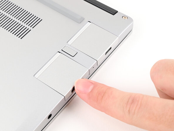

    2. Framework Laptop 13 Mainboard Replacement: step 3, image 1 of 2 Framework Laptop 13 Mainboard Replacement: step 3, image 2 of 2
      • Slide the Expansion Card out of its slot and remove it.
      • Remove the remaining Expansion Cards.

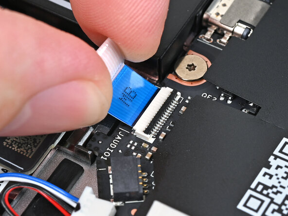

    2. Framework Laptop 13 Mainboard Replacement, Disconnect the Audio Board: step 18, image 1 of 2 Framework Laptop 13 Mainboard Replacement, Disconnect the Audio Board: step 18, image 2 of 2
      • Use the flat end of your Framework Screwdriver, or a clean fingernail, to lift up the locking tab on the Audio Board ZIF connector on the Mainboard.
      Ask FixBot
    3. Framework Laptop 13 Mainboard Replacement: step 19, image 1 of 2 Framework Laptop 13 Mainboard Replacement: step 19, image 2 of 2
      • Use your fingers to lightly grip the Audio Board cable and slide it straight out of its socket.
      Ask FixBot

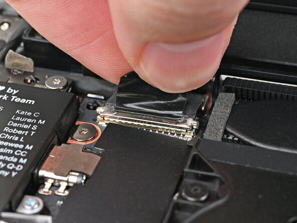

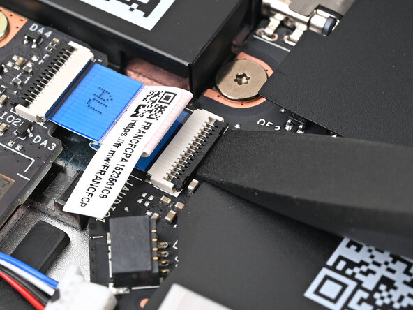

    4. Framework Laptop 13 Mainboard Replacement, Disconnect the eDP Cable: step 20, image 1 of 2 Framework Laptop 13 Mainboard Replacement, Disconnect the eDP Cable: step 20, image 2 of 2
      • Grip the eDP Cable connector by its pull tab and lift up to disconnect it.
      Ask FixBot

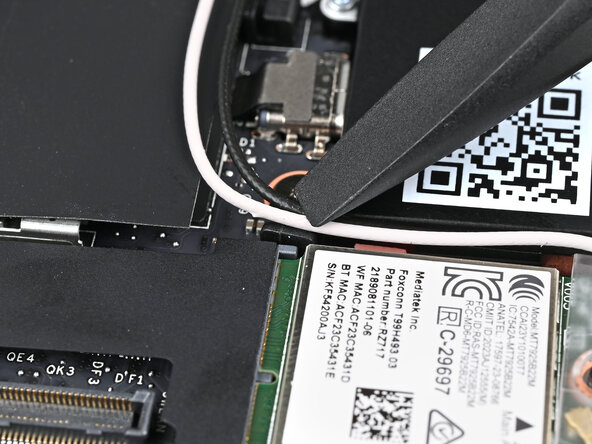

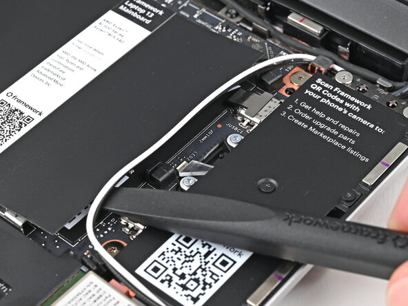

    6. Framework Laptop 13 Mainboard Replacement, Lift the antenna cables: step 22, image 1 of 3 Framework Laptop 13 Mainboard Replacement, Lift the antenna cables: step 22, image 2 of 3 Framework Laptop 13 Mainboard Replacement, Lift the antenna cables: step 22, image 3 of 3
      • Use the flat end of the Framework Screwdriver to lift the two antenna cables out of their rubber clips on the Mainboard.
      Ask FixBot

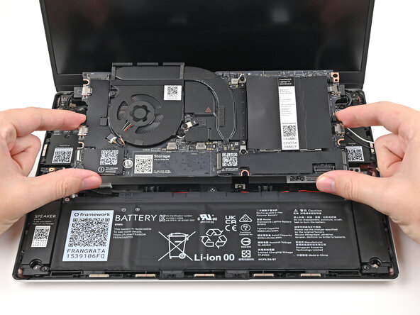

    10. Framework Laptop 13 Mainboard Replacement, Remove the Mainboard: step 26, image 1 of 3 Framework Laptop 13 Mainboard Replacement, Remove the Mainboard: step 26, image 2 of 3 Framework Laptop 13 Mainboard Replacement, Remove the Mainboard: step 26, image 3 of 3
      • Use your fingers to lift the bottom edge of the Mainboard enough to grip its edges.
      • Lift the Mainboard off its alignment pegs and remove it.
      Ask FixBot

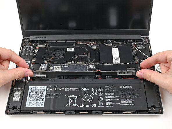

    1. Framework Laptop 13 Mainboard Replacement, Place the Mainboard: step 28, image 1 of 2 Framework Laptop 13 Mainboard Replacement, Place the Mainboard: step 28, image 2 of 2
      • Grab the Mainboard by its edges and place it into the laptop and onto its alignment pegs.
      • Make sure all of the cables are above the Mainboard before continuing. Refer to this image for where the cables are located.

    8. Framework Laptop 13 Mainboard Replacement, Reroute the antenna cables: step 35, image 1 of 3 Framework Laptop 13 Mainboard Replacement, Reroute the antenna cables: step 35, image 2 of 3 Framework Laptop 13 Mainboard Replacement, Reroute the antenna cables: step 35, image 3 of 3
      • Use the flat end of your Framework Screwdriver to press the two antenna cables into their rubber clips on the Mainboard.

    1. Framework Laptop 13 Mainboard Replacement, Check the Touchpad Cable: step 51, image 1 of 3 Framework Laptop 13 Mainboard Replacement, Check the Touchpad Cable: step 51, image 2 of 3 Framework Laptop 13 Mainboard Replacement, Check the Touchpad Cable: step 51, image 3 of 3
      • Before continuing, check the Touchpad Cable's ZIF connector located on the back of the Touchpad:
      • Make sure the white line on the cable is parallel to and adjacent with the socket.
      • If the cable isn't inserted far enough, use the flat end of the Framework Screwdriver to flip up the black latch, reposition the cable, and lock the latch.
      Ask FixBot

    1. Framework Laptop 13 Mainboard Replacement, Install the Expansion Cards: step 57, image 1 of 3 Framework Laptop 13 Mainboard Replacement, Install the Expansion Cards: step 57, image 2 of 3 Framework Laptop 13 Mainboard Replacement, Install the Expansion Cards: step 57, image 3 of 3
      • Slide an Expansion Card into an Expansion Card slot.
      • You don't need to hold down the release button to install the Expansion Cards—only when you want to remove them.
      • The Expansion Cards should click into place, and the front edge should be flush with the laptop.
      • For Expansion Card compatibility, check here.
      • Repeat for the remaining Expansion Cards.
