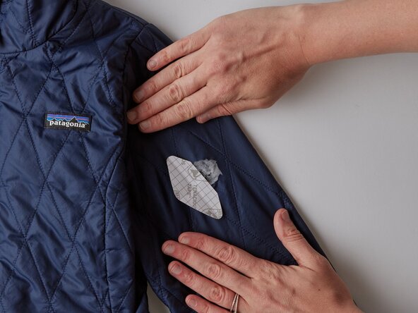

    4. Advanced Gear Tape Techniques, Shaping Patch to Design: step 4, image 1 of 3 Advanced Gear Tape Techniques, Shaping Patch to Design: step 4, image 2 of 3 Advanced Gear Tape Techniques, Shaping Patch to Design: step 4, image 3 of 3
      • Whenever possible, choose or cut a patch that follows the garment’s design lines. This improves the look of the repair and helps avoid patching over seams.
      • While patching over seams is sometimes unavoidable, positioning patches away from seams when possible improves adhesion and makes future repairs easier.
      • Consider shapes that align with:
      • Diamond baffles
      • Curved seams
      • Sharp angular fabric pieces
      Ask FixBot
