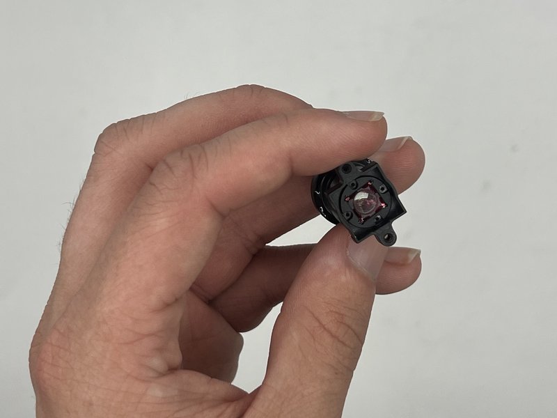

      • Remove the camera.
      Ask FixBot
    1. Abask J05 Camera Lens Replacement, Camera Lens: step 11, image 1 of 2 Abask J05 Camera Lens Replacement, Camera Lens: step 11, image 2 of 2
      • The piece under the camera is the camera lens.
      • Remove the camera lens from the device.
      Ask FixBot
