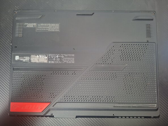

    2. ASUS ROG Strix G15 G513 Screen Replacement: step 2, image 1 of 1

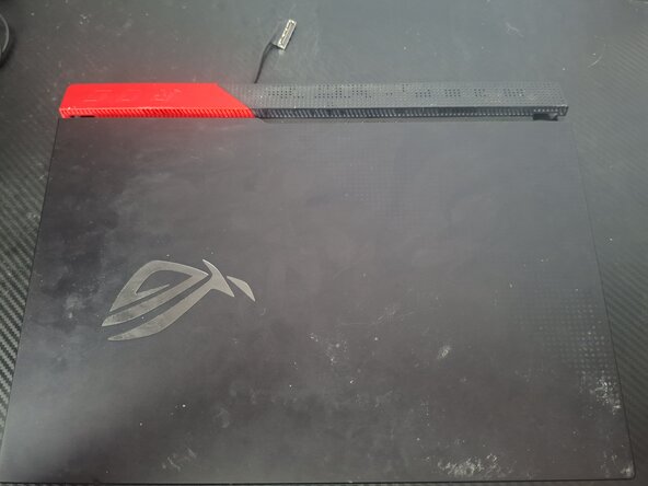

      • Turn your laptop upside down
      • Start unscrewing all 10 blue and orange screws with a Philips #1 screwdriver
      • The blue and orange screws are different length
      • Unscrew the red screw always last and screw it in always first
      Ask FixBot

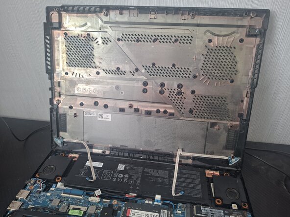

    5. ASUS ROG Strix G15 G513 Screen Replacement: step 5, image 1 of 3 ASUS ROG Strix G15 G513 Screen Replacement: step 5, image 2 of 3 ASUS ROG Strix G15 G513 Screen Replacement: step 5, image 3 of 3

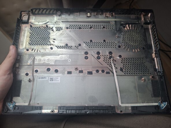

      • Start by peeling from the bottom right corner slowly until the entire back cover comes off
      • Rotate your laptop
      • Beware of 2 thin LED ribbon cables that are still attached
      Ask FixBot

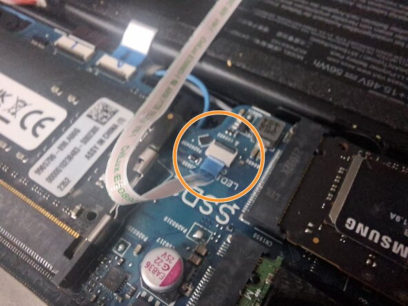

    6. ASUS ROG Strix G15 G513 Screen Replacement: step 6, image 1 of 3 ASUS ROG Strix G15 G513 Screen Replacement: step 6, image 2 of 3 ASUS ROG Strix G15 G513 Screen Replacement: step 6, image 3 of 3
      • Now you need to unplug them
      • Start by lifting the small black part of the connector up
      • Then just pull the cable away
      Ask FixBot
    7. ASUS ROG Strix G15 G513 Screen Replacement: step 7, image 1 of 3 ASUS ROG Strix G15 G513 Screen Replacement: step 7, image 2 of 3 ASUS ROG Strix G15 G513 Screen Replacement: step 7, image 3 of 3
      • Do the same for the other cable connector
      Ask FixBot

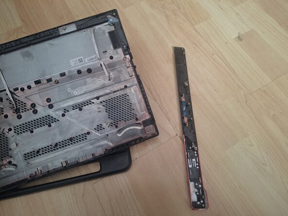

      • Now remove the back cover completely
      Ask FixBot

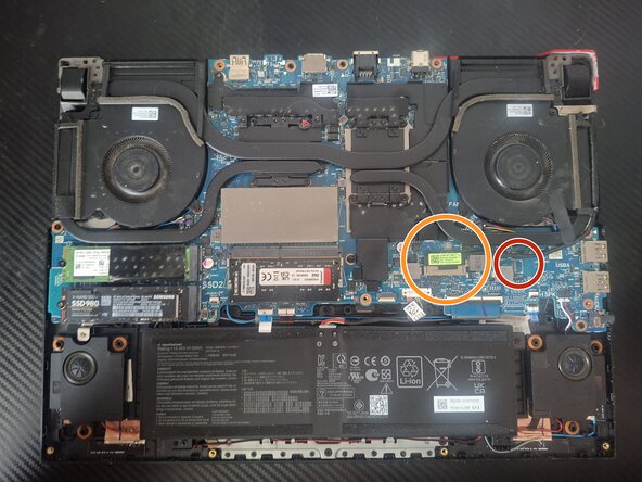

      • Now you need to disconnect the battery
      • Locate the connector
      • Pull the top tin lock away from you as seen on image 1 vs 2
      • Then disconnect the battery connector by supporting it from sides and lifting it up
      Ask FixBot

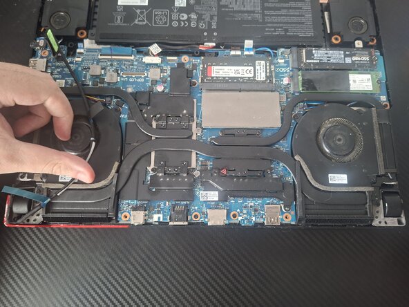

    10. ASUS ROG Strix G15 G513 Screen Replacement: step 10, image 1 of 1
      • Rotate your laptop again
      • Locate your EDP cable connector
      • If you have a better model you will have an additional connector the EDP cable won't have 2 connectors but 4 ones that go together everywhere, the second pair of connectors is for the asus rog logo lighting on the screen back cover
      Ask FixBot
    11. ASUS ROG Strix G15 G513 Screen Replacement: step 11, image 1 of 2 ASUS ROG Strix G15 G513 Screen Replacement: step 11, image 2 of 2
      • Unscrew these 4 screws and disconnect your EDP cable
      Ask FixBot

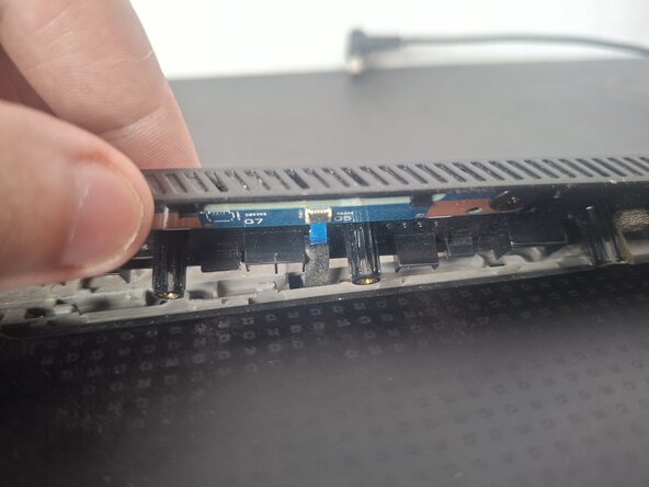

    12. ASUS ROG Strix G15 G513 Screen Replacement: step 12, image 1 of 3 ASUS ROG Strix G15 G513 Screen Replacement: step 12, image 2 of 3 ASUS ROG Strix G15 G513 Screen Replacement: step 12, image 3 of 3

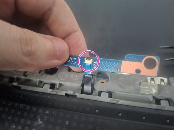

      • Try to lift/pry that colorful small panel if it is interchangeable if it's not, lift the whole panel
      • Be careful under the panel is a small board that has a small connector
      Ask FixBot
    13. ASUS ROG Strix G15 G513 Screen Replacement: step 13, image 1 of 3 ASUS ROG Strix G15 G513 Screen Replacement: step 13, image 2 of 3 ASUS ROG Strix G15 G513 Screen Replacement: step 13, image 3 of 3
      • Carefully lift the small black rectangle latch up to disconnect the small ribbon cable and disconnect the cable
      • You can put away the panel now

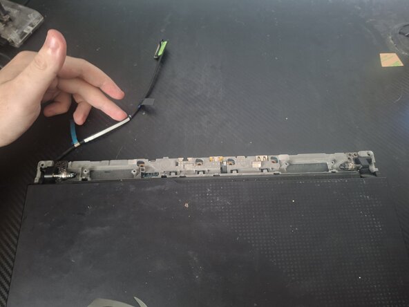

    16. ASUS ROG Strix G15 G513 Screen Replacement: step 16, image 1 of 3 ASUS ROG Strix G15 G513 Screen Replacement: step 16, image 2 of 3 ASUS ROG Strix G15 G513 Screen Replacement: step 16, image 3 of 3

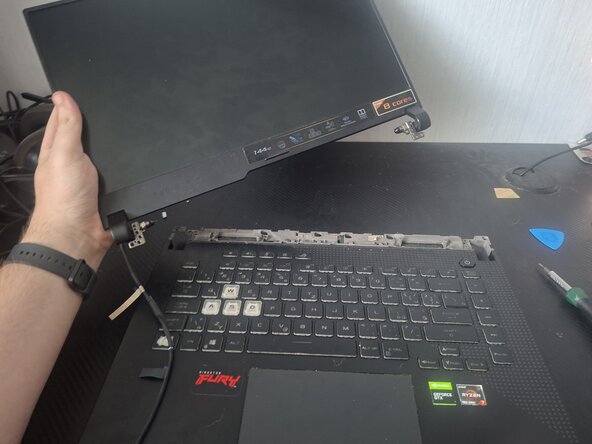

      • Slowly lift your whole screen
      • The hinges will come off
      • Tread the EDP cable through the hinge and out
      Ask FixBot
    17. ASUS ROG Strix G15 G513 Screen Replacement: step 17, image 1 of 3 ASUS ROG Strix G15 G513 Screen Replacement: step 17, image 2 of 3 ASUS ROG Strix G15 G513 Screen Replacement: step 17, image 3 of 3
      • Now you can remove your screen completely
      • Prepare your new screen
      • Start putting your new screen in

      • Now we should put this panel back in, but you are going to notice how hard it is to connect that small ribbon connector
      • Instead, unscrew that small board from that panel
      Ask FixBot
    20. ASUS ROG Strix G15 G513 Screen Replacement: step 20, image 1 of 2 ASUS ROG Strix G15 G513 Screen Replacement: step 20, image 2 of 2
      • Next connect the ribbon cable to that small board and secure it in the connector
      • Then, from an angle screw those 2 screws back in

    25. ASUS ROG Strix G15 G513 Screen Replacement: step 25, image 1 of 1
      • Put the back cover against a wall so that you can reconnect the LED flex cables without the need of holding it
      Ask FixBot
    26. ASUS ROG Strix G15 G513 Screen Replacement: step 26, image 1 of 2 ASUS ROG Strix G15 G513 Screen Replacement: step 26, image 2 of 2
      • Push the left cable in until you can barely see the white line on the blue part of the cable
      • Secure it by pressing the black latch down
      Ask FixBot
