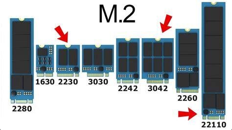

It says PCIe 4.0 on the second image of the shop link you provided, and it's an nvme m.2 with the "size" 2280. What you're looking for is something with this form factor and pins
It supports sizes and I quote "2230, 2242, 2260, and 2280mm"
The likelihood of buying older or smaller form factor units is next to 0 in the US and EU, I know because I spent 2 hours shopping for one yesterday.
Here's the various sizes of M.2 SSD's:
