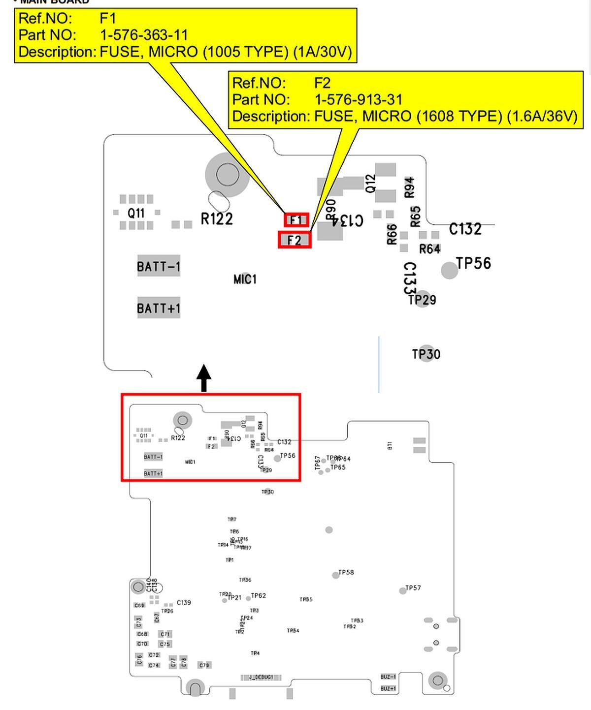

@priyeshcamera if you are sure you have a good battery and if your battery case door functions properly, time to take it apart. Use this guide Sony Cyber-shot DSC-S2100 LCD Replacement to get into your camera. Once there, you need to check the motherboard. Make sure that the battery cables are properly attached and then check the fuse for continuity. One is the power fuse.
