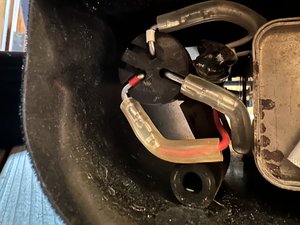

Tested continuity on the wire to the electrodes, passed. One electrode (White, Mid) had some carbon buildup, but nothing too irregular. Cleaned with scotch-brite and replaced.

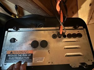

@jayeff The numbers 1-10 do not show up. The unit hasn't initialized, so not the error codes mentioned in the pdf. Here's a reference to what the bottom of the unit looks like. I did not install or buy this client's unit, so I'm not sure if the fuses were skipped, or this is stock. It does however disagree with the manual's photo I shared above.

You say that the "unit" doesn't appear to have a glass fuse. Is there provision for a fuse in the unit as shown in the image you posted?
Not having a fuse, glass or otherwise (ceramic cartridge?) when there's provision for one by way of a fuse holder might be worth looking at.

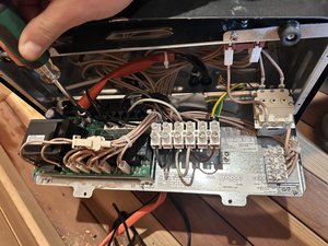

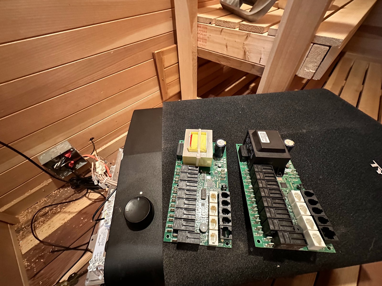

After much ado, and troubleshooting nearly every system component, I received and and replaced the PCA (printed circuit assembly). The RJ ports on the old board seemed to wiggle around a bit. My assumption was that heat cycling damaged the connections and caused miscommunication with the control unit. I inspected the board and didn't see any other obvious solder joint issues.
This took about 10 minutes and two screws, two clip fasteners, and about 20 labelled wires...with matching labels on the board! The spade connectors came off much easier with a flathead.
I flipped the breaker, and rebooted the machine. The sauna booted right up.
The most unfortunate part of this repair is that the local weather read 103 deg F (40 deg C), and it seems the cold part of the year is over with. I can't wait to use the unit in the fall!

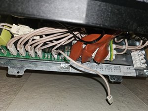

I have also replaced the circuit board but am left with a loose end connector from X14, can you show me where the other end is connected?
