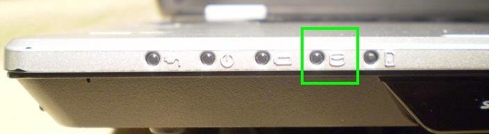

Laptop Turns On, but Not the Screen
Check to make sure the hard drive indicators (top right) show activity.
If they do:
  • Look very closely at the display (screen) to see if you can see a very faint image on the screen. If you can, this would indicate a problem with the display’s back-light.
  • Plug an external monitor into the VGA port (right bottom) Enable the external display (Fn+F5)
    • If an image appears, the computer is OK, and the back-light is the problem
    • If it does not, the problem may lie with the video card.
