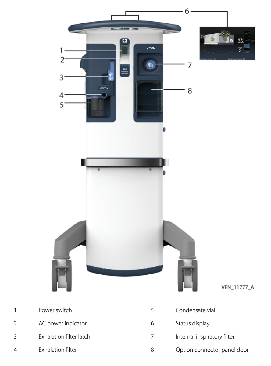

Touch Screen Response Not Fixed After Reset
If the touch screen response still does not respond as expected, the operator should provide an alternate source of ventilation to the patient to allow for power cycling the device. After the patient is safely transferred to another ventilation system, power the device off and back on using the power switch on the front of the device (See BDU Front View). If appropriate, the patient can be transferred back to the device. If the patient is going to be transferred back, press the “Same Patient” key on the display followed by “Start”.
BDU Front View
BDU Front View
