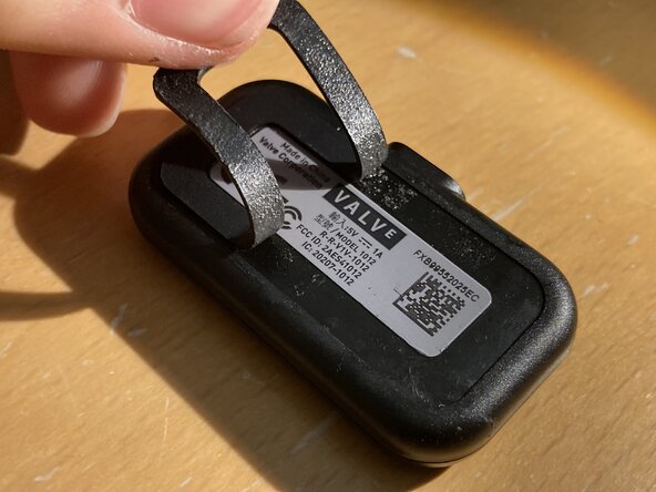

    • The Steam Controller Puck is both a charging dock, and wireless receiver for the controller. The front exposes 3 pogo pins for charging the controller. The Puck attaches magnetically to the bottom of the controller.
    • The underside consists of a sticker, and a rubber foot. No screws are hidden under the rubber foot, so no need to remove it.

    • Disassembling the puck is surprisingly easy, first insert a spudger on the underside of the USB-C port.
    • Push in the spudger until the plastic shell splits. The puck contains no plastic clips to break, so keep pushing until there's space to insert a pick on the right side (when turned upside down).
    • Make sure not to insert the pick on the left side, as you risk knocking surface mount components off the PCB.

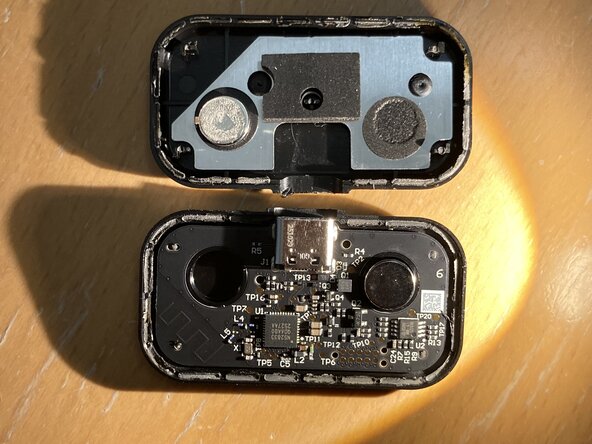

  4. Steam Controller (2nd Generation) Wireless Puck Teardown, Take the puck apart: step 4, image 1 of 3 Steam Controller (2nd Generation) Wireless Puck Teardown, Take the puck apart: step 4, image 2 of 3 Steam Controller (2nd Generation) Wireless Puck Teardown, Take the puck apart: step 4, image 3 of 3
    • You should now be able to pry off the bottom shell of the puck. It's held together by magnets and the adhesive on the left side, so give it a good tug.

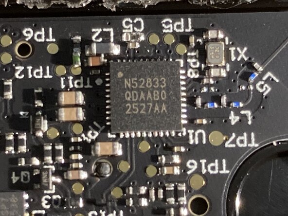

    • Here's a few photos i took of the internals. The processor is an nRF52833.

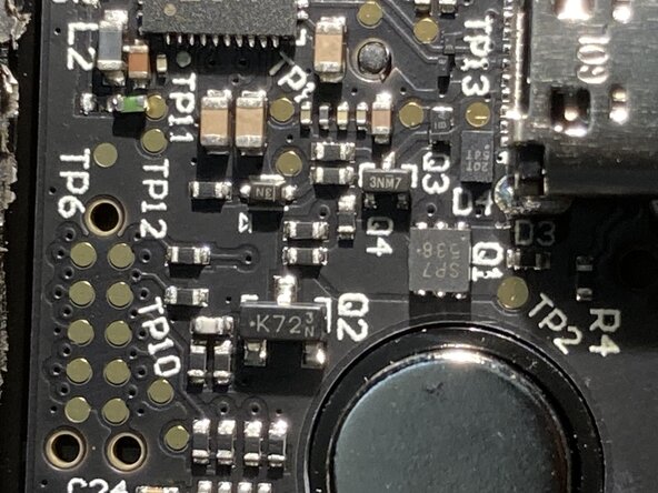

    • In the second photo you can see a green capacitor I knocked loose while opening the puck (top left, right above TP11). I tried to solder it back onto the board, but couldn't do it because it's incredibly small. Luckily, the puck still works fine.
    • Photo 3 shows the capacitor on the end of ceramic tweezers next to the assembled puck.
    Ask FixBot
  6. Steam Controller (2nd Generation) Wireless Puck Teardown, More photos: step 6, image 1 of 2 Steam Controller (2nd Generation) Wireless Puck Teardown, More photos: step 6, image 2 of 2
    • Photo 1 shows a AS393MM-G1, dual voltage comparator. No idea what it's used for
    • Photo 2 is a close-up of the rest of the components on the board

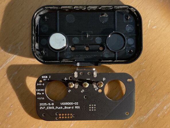

    • The back of the PCB is mostly bare, except for the pogo pins that connect the puck to the steam controller.
    • The text on the back tells us, that this PCB revision was designed 8. September 2025. Assuming the number 45256 is a date code, with format WWYYD, we get week 45 of 2025 weekday 6, which is the 8. November, 2025. This means my puck's PCB was produced almost 6 months before the controller released. Neat!
