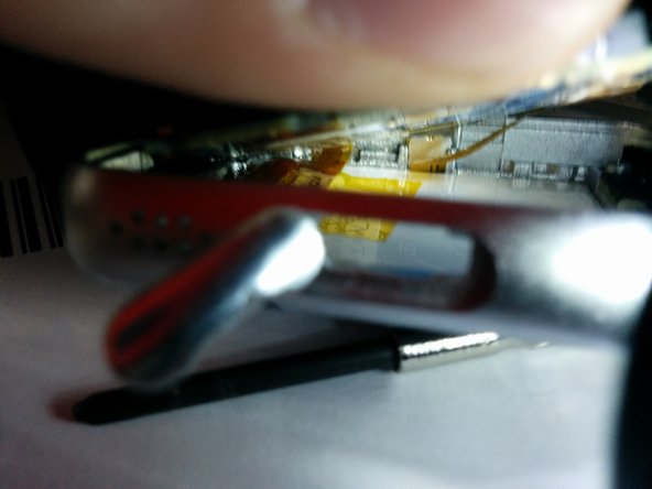

  7. GV30 Teardown, Now only the red&black cables are connected: step 7, image 1 of 2 GV30 Teardown, Now only the red&black cables are connected: step 7, image 2 of 2
    • Lift the plastic frame to view the circuit
    • The gray wire cloth used for cooling or shielding blocks the view of the chip below it.l, so remove it

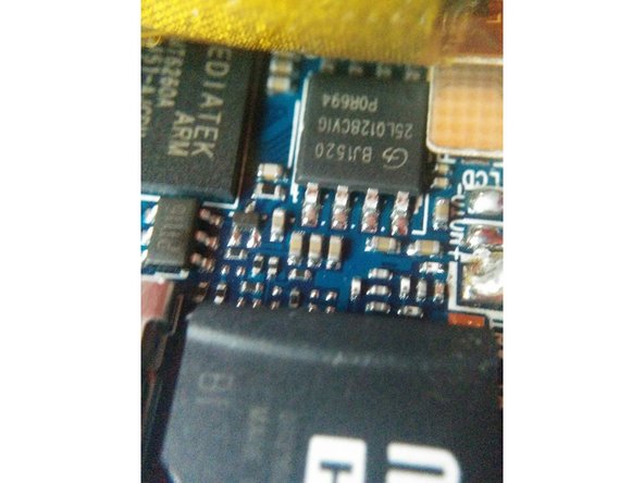

  8. GV30 Teardown, Look at the elements of the circuit: step 8, image 1 of 3 GV30 Teardown, Look at the elements of the circuit: step 8, image 2 of 3 GV30 Teardown, Look at the elements of the circuit: step 8, image 3 of 3
    • Mediatek mt6260a processor

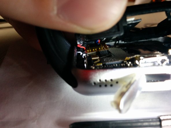

  12. GV30 Teardown, Cable 3: step 12, image 1 of 3 GV30 Teardown, Cable 3: step 12, image 2 of 3 GV30 Teardown, Cable 3: step 12, image 3 of 3
    • Another cable having a locking bar. I tried to move this cable too and having more space I forced it more than the previous one but nothing moved.

  14. GV30 Teardown, The last thing i notice is this chip: step 14, image 1 of 3 GV30 Teardown, The last thing i notice is this chip: step 14, image 2 of 3 GV30 Teardown, The last thing i notice is this chip: step 14, image 3 of 3
    • The chip is connected with the third cable

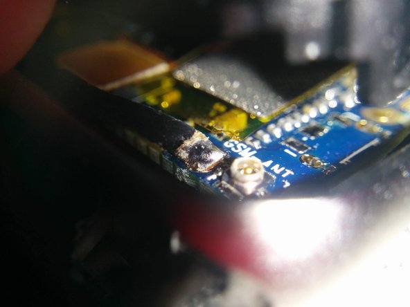

  15. GV30 Teardown, See the bt_ant near the on/off button: step 15, image 1 of 2 GV30 Teardown, See the bt_ant near the on/off button: step 15, image 2 of 2
    • I had to remove the micro sd to see it, also if i described the same antenna in 6th step whitout realizing. It seems to have only 1 connection to the board and seems to be 1 thin copper plate all united. Unfortunately i ripped the antenna in the 2nd photo ! Now i need to replace the antenna with another.

  16. GV30 Teardown, The antenna i have is a simple wifi's one (i think: step 16, image 1 of 3 GV30 Teardown, The antenna i have is a simple wifi's one (i think: step 16, image 2 of 3 GV30 Teardown, The antenna i have is a simple wifi's one (i think: step 16, image 3 of 3
    • The problem is that this antenna have 2 connections while the previous had only 1 ! I don't know what are these connections. Maybe one connects simply to ground, but i don't know. I think it's a SMA connector. I expect if i peel the cable to get 2 cables.
    Ask FixBot
  17. GV30 Teardown, Completed !: step 17, image 1 of 3 GV30 Teardown, Completed !: step 17, image 2 of 3 GV30 Teardown, Completed !: step 17, image 3 of 3
    • The cable is about 2cm long and wide 2mm , i not measured it but works very well. I don'k know even if it touches the contact or is only near it.
    • If i connect another piece of wire on the antenna the range of the bluetooth remain practically the same. Maybe to increase further the range, i need a determinate-lenght wire , for example with a online calculator the lenght of the ideal antenna results a quarter of wave of 2,450 ghz but i don't know how much is important
