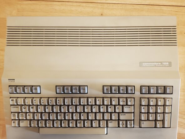

  1. Commodore 128 Teardown, Case Screws: step 1, image 1 of 1
    • Flip your commodore 128 over
    • Remove the five Phillips screws with a PH1 screwdriver.
    Ask FixBot
  2. Commodore 128 Teardown, Cover Remove: step 2, image 1 of 1
    • Flip your commodore over (again), so the keyboard is facing up.
    • Slowly lift the top keyboard cover up
    • Be careful, as there are some wires under the cover!
    Ask FixBot
  3. Commodore 128 Teardown, Power Light cable removal: step 3, image 1 of 1
    • On the right side of the keyboard, remove the Power Light cable.
    Ask FixBot
  4. Commodore 128 Teardown, Keyboard/Grounding Removal: step 4, image 1 of 1
    • Remove the Grounding Cable on the right by unscrewing the screw with a PH1 bit.
    • Remove the keyboard connector buy carefully pulling it out
    • Do not force the keyboard connector out! If it wont come out, you can continue by flipping the keyboard to the side. (I ended up not taking it out)
    Ask FixBot
  5. Commodore 128 Teardown, RF shield removing: step 5, image 1 of 2 Commodore 128 Teardown, RF shield removing: step 5, image 2 of 2
    • Remove the six small screws holding the RF Shield in.
    • Remove the single smaller screw
    Ask FixBot
  6. Commodore 128 Teardown, 2nd RF thingy: step 6, image 1 of 2 Commodore 128 Teardown, 2nd RF thingy: step 6, image 2 of 2
    • Remove the 2nd RF shield thingy (not sure what it is)
    • To reassemble your device, follow these instructions in reverse order.
