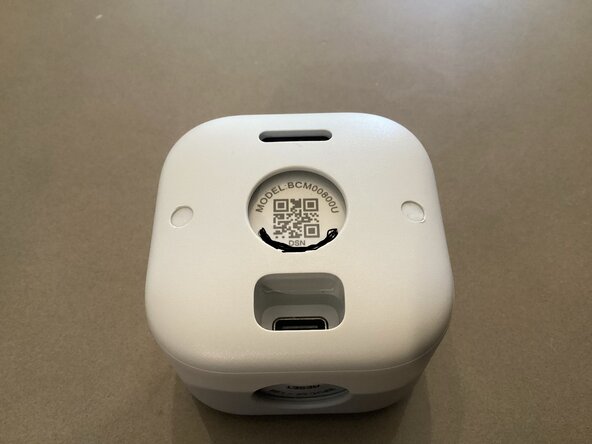

    • This is a Blink Mini 2K+ Indoor/Outdoor security camera. It retails for $39.99 down to $25.99 as of 2026, and has decent quality for its price. It also is IP-65 water resistant against rain.
    • It features night-vision capabilities, 2K video quality, AI smart detection, noice cancellation, and much more.
    • It also is quite small too, I expect very small chips across multiple crammed PCB’s.
    • You do also have to download an app with the camera, which still works without a subscription, but doesn’t have full AI and cloud software features unless you purchase the full subscription plan.

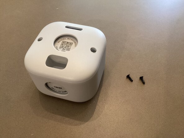

    • To begin disassembly of your camera, use some tweezers or a toothpick to slowly push out the small rubber inserts covering the two screws.
    • Use a long Philips head screwdriver to unscrew the 2 screws. Make sure to keep track of both the screws and rubber inserts as they are quite small, and easy to loose.

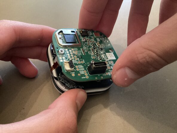

    • To start removal of the PCB module, disconnect the ribbon cable connecting the main board to the sensors underneath the secondary board below the main board.
  5. Blink Camera Teardown: step 5, image 1 of 3 Blink Camera Teardown: step 5, image 2 of 3 Blink Camera Teardown: step 5, image 3 of 3
    • After removing the ribbon/flex cable, gently pull up on the PCB to separate it from the bottom PCB.
    • The two PCB’s are connected by a large connector and the flex cable that has already been removed.
