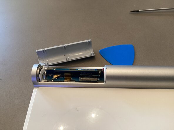

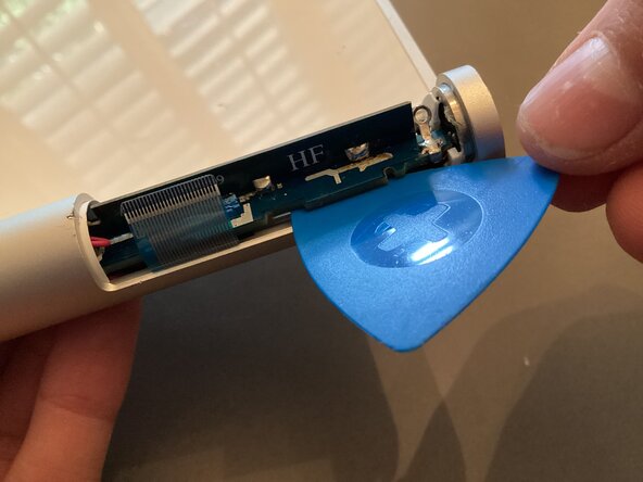

  3. Apple Wireless Keyboard Teardown: step 3, image 1 of 3 Apple Wireless Keyboard Teardown: step 3, image 2 of 3 Apple Wireless Keyboard Teardown: step 3, image 3 of 3
    • To start actual disassembly, use a flathead or opening pick to pry off the plastic covering the antenna and the main board underneath.
    • Be careful, as there is a coax cable, a ribbon cable to the keyboard membrane, and the antenna board right underneath. You don’t want to risk damaging any of these.

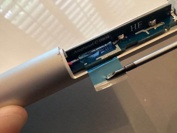

  4. Apple Wireless Keyboard Teardown: step 4, image 1 of 3 Apple Wireless Keyboard Teardown: step 4, image 2 of 3 Apple Wireless Keyboard Teardown: step 4, image 3 of 3
    • For the next step, use a flathead or a toothpick to unlatch the flex cable connecting to the keyboard membrane. Try very carefully as you can easily damage the flex cable.
    • Disconnecting the coax cable isn’t necessary unless you were to replace the antenna board.
