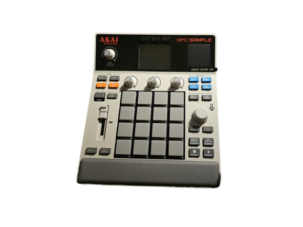

  1. Akai MPC Sample Teardown, Remove the front knobs and faders: step 1, image 1 of 1
    • Alright. Depending on how deep you're intending to get into the device, you will need to remove the three knob caps, the fader cap, the master encoder knob (you'll also need a wrench as the potentiometer for this is held in place by a threaded nut).

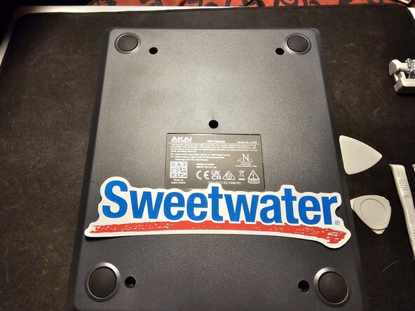

  2. Akai MPC Sample Teardown, Remove the 5 screws on the back: step 2, image 1 of 2 Akai MPC Sample Teardown, Remove the 5 screws on the back: step 2, image 2 of 2
    • There are 5 screws on the back. They are phillips screws, pretty easy.
    Ask FixBot
    • 3 of the sides are pretty easy to pop open with the guitar pick shaped plastic devices, but the last side (the bottom) has a series of 4 or 5 tabs held in place by friction. I was able to pry them up via a plastic spudger
    Ask FixBot
