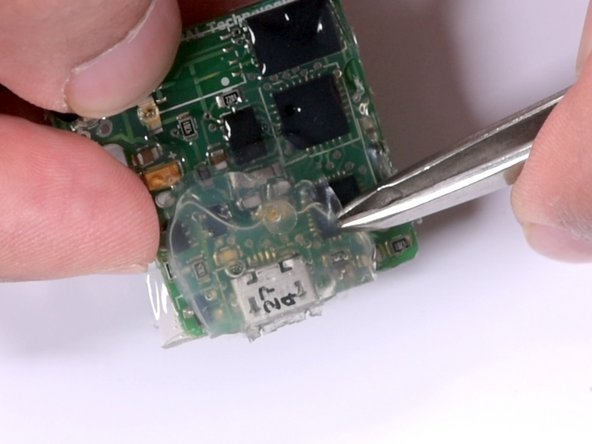

      • The EVA glue was removed by scraping using a plastic spudger and then pulling the glue off using tweezers.

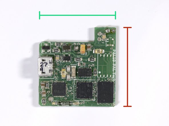

      • Width: 29mm
      • Length: 30mm
      • Be careful while scraping the glue. It is possible to poke yourself with the spudger. Always scrape away from your fingers!
      • Dispose of the glue residue from the scraping. Keep away from children and pets.
      • This is not the most efficient way to remove the glue. It took 20 minutes of scraping. One capacitor also came off while removing the glue.
      • Alternative chemical methods may be more useful in this step, but they may be difficult to obtain locally and not suitable for home use.

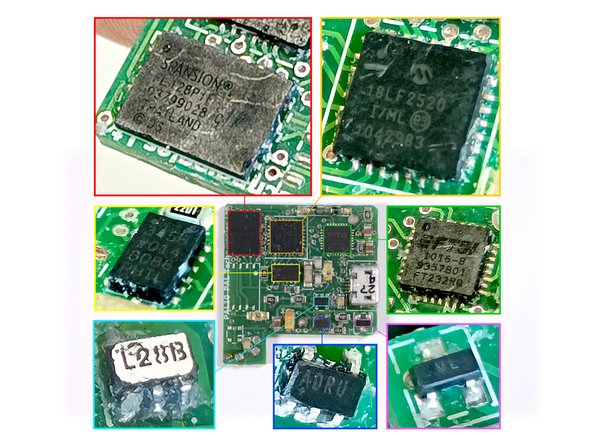

    5. ActivPAL 3 Teardown, Studying the PCB components: step 5, image 1 of 2 ActivPAL 3 Teardown, Studying the PCB components: step 5, image 2 of 2
      Ask FixBot
