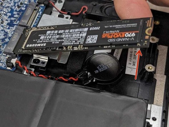

    1. why! NS5xAU SSD Replacement, SSD: step 4, image 1 of 3 why! NS5xAU SSD Replacement, SSD: step 4, image 2 of 3 why! NS5xAU SSD Replacement, SSD: step 4, image 3 of 3
      • Unscrew the screw.
      • Lift the SSD and remove it.
