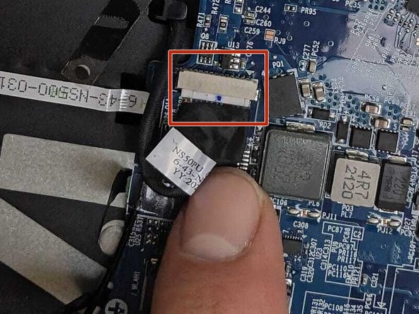

      • Unplug the cables.
      Ask FixBot
    3. why! NS5xAU Motherboard Replacement, Motherboard 3: step 17, image 1 of 3 why! NS5xAU Motherboard Replacement, Motherboard 3: step 17, image 2 of 3 why! NS5xAU Motherboard Replacement, Motherboard 3: step 17, image 3 of 3
      Ask FixBot

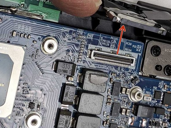

    4. why! NS5xAU Motherboard Replacement, Motherboard 4: step 18, image 1 of 3 why! NS5xAU Motherboard Replacement, Motherboard 4: step 18, image 2 of 3 why! NS5xAU Motherboard Replacement, Motherboard 4: step 18, image 3 of 3
      • Unscrew the screws.
      Ask FixBot
