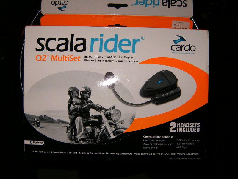

This bike-to-bike intercom system was given to me by a friend for repair. He is an avid bike rider and purchased this set a while ago but did not have time to ever use it. Once he did try to charge it it would not take a charge. I assumed that it was the batteries since they have never been charged. They may have been depleted below the threshold of where they would accept a charge. When he called the cardo support number he was told that "There is no out of warranty service for scala rider batteries." He would need to purchase a new scala rider headset in this case. Really? Lets check this myth about the "not user serviceable" battery.

    1. scala rider Q2 multiSet battery replacement, battery: step 1, image 1 of 3 scala rider Q2 multiSet battery replacement, battery: step 1, image 2 of 3 scala rider Q2 multiSet battery replacement, battery: step 1, image 3 of 3
      • scala rider Q2 bike-to-bike intercom. Retail price $379.99 and never used.
      • Individual unit with carrying pouch
      • Back of the bluetooth intercom device
