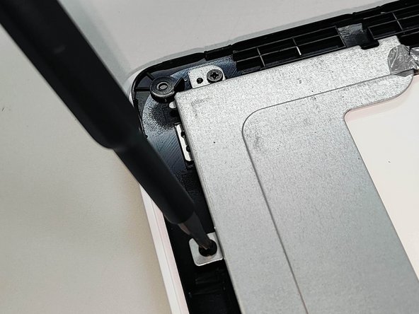

  3. jp.ik Leap T304 LCD Replacement Replacement: step 3, image 1 of 1
    • Remove all screws with a Philips PH1 screwdriver
    • All screws are the same, don't worry about identifying them.

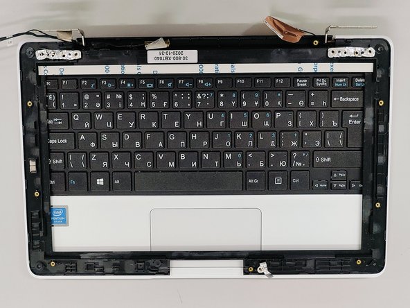

  4. jp.ik Leap T304 LCD Replacement Replacement: step 4, image 1 of 3 jp.ik Leap T304 LCD Replacement Replacement: step 4, image 2 of 3 jp.ik Leap T304 LCD Replacement Replacement: step 4, image 3 of 3
    • Using the plastic tool, insert it between the plastic and open it carefully.
    • You will feel and hear several clicks, which are perfectly normal. Remove the rear LCD Cover completely.

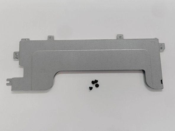

  5. jp.ik Leap T304 LCD Replacement Replacement: step 5, image 1 of 3 jp.ik Leap T304 LCD Replacement Replacement: step 5, image 2 of 3 jp.ik Leap T304 LCD Replacement Replacement: step 5, image 3 of 3
    • Unscrew both hinges.

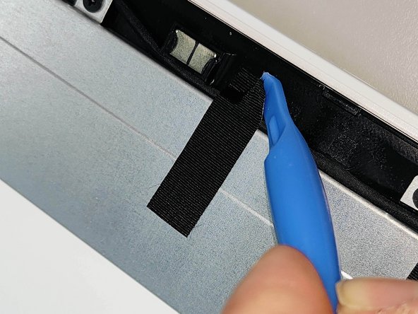

  7. jp.ik Leap T304 LCD Replacement Replacement: step 7, image 1 of 3 jp.ik Leap T304 LCD Replacement Replacement: step 7, image 2 of 3 jp.ik Leap T304 LCD Replacement Replacement: step 7, image 3 of 3
    • Remove the mylers shown in the image.
