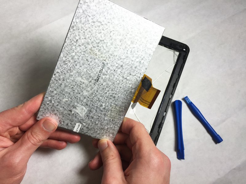

    1. iView-776TPCII Digitizer Replacement, Digitizer: step 13, image 1 of 3 iView-776TPCII Digitizer Replacement, Digitizer: step 13, image 2 of 3 iView-776TPCII Digitizer Replacement, Digitizer: step 13, image 3 of 3
      • Insert the plastic opening tool between the digitizer and the screen. Use a prying motion to loosen the digitizer from its plastic case.
      • If you find it hard to separate the two components at first, try to use another plastic opening tool for support.
      • Continue moving along the edge of the digitizer until it is fully separated.
