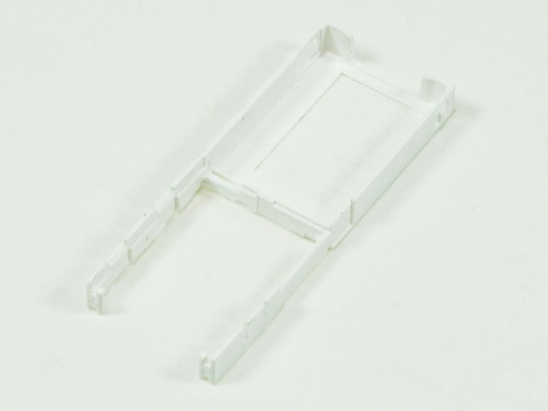

    1. iPod Shuffle 1st Generation Framework Replacement, Framework: step 19, image 1 of 1
      • Plastic framework remains.
