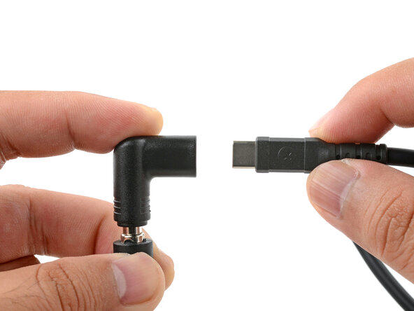

    1. iPhone Air Battery Replacement, Assemble the VoltClip: step 23, image 1 of 2 iPhone Air Battery Replacement, Assemble the VoltClip: step 23, image 2 of 2
      Tool used on this step:
      VoltClip
      $10.95
      Buy
      • The guide uses the VoltClip to release the adhesive. If you're using a different method, such as a 9V battery, follow the guide normally and supplement your power source's operating procedures during the necessary steps.
      • Plug the VoltClip's barrel connector into the USB-C elbow.
      • Don't connect the VoltClip to a power source just yet. The loose alligator clips may accidentally touch each other and cause an electrical short.

    4. iPhone Air Battery Replacement, Connect power to the VoltClip: step 26, image 1 of 3 iPhone Air Battery Replacement, Connect power to the VoltClip: step 26, image 2 of 3 iPhone Air Battery Replacement, Connect power to the VoltClip: step 26, image 3 of 3
      • Make sure the red alligator clip is secured. If the black alligator clip pops off its screw, disconnect the USB-C cable, reseat the clip, and try again.
      • Connect the USB‑C elbow to a power source (via a USB‑C cable) and wait 90 seconds for the adhesive to loosen.
