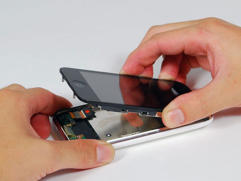

    3. iPhone 3G Display Assembly Replacement: step 4, image 1 of 1
      • The display assembly is still connected to the iPhone by several cables, so don't try to remove it entirely just yet.
      • Rotate the display assembly up until it is at an angle of approximately 45 degrees.

    4. iPhone 3G Display Assembly Replacement: step 5, image 1 of 1
      • Continue to hold the display assembly with one hand, and use your other hand and a spudger to disconnect the black ribbon cable labeled "1."
