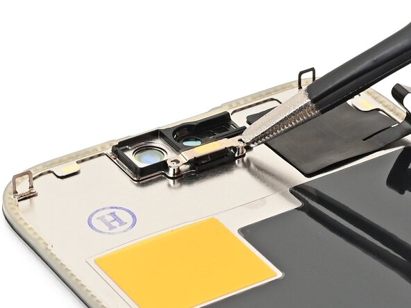

    1. iPhone 15 Pro Screen Replacement, Ambient light sensor information: step 25, image 1 of 2 iPhone 15 Pro Screen Replacement, Ambient light sensor information: step 25, image 2 of 2
      • Check if your new screen comes with an ambient light sensor installed.
      • If it doesn't, follow the remaining steps to remove and transfer the sensor from your original screen to your replacement.
      Ask FixBot
    2. iPhone 15 Pro Screen Replacement, Remove the ambient light sensor cover screws: step 26, image 1 of 2 iPhone 15 Pro Screen Replacement, Remove the ambient light sensor cover screws: step 26, image 2 of 2
      • Use a Phillips #000 driver to remove the two 1.4 mm-long screws securing the ambient light sensor cover.
      Ask FixBot
    3. iPhone 15 Pro Screen Replacement, Remove the ambient light sensor cover: step 27, image 1 of 1
      • Remove the ambient light sensor cover.
      Ask FixBot
    4. iPhone 15 Pro Screen Replacement, Heat the ambient light sensor adhesive: step 28, image 1 of 1
      • Be careful not to overheat the screen—the plastic components can melt if they get too hot.
      • Use a hair dryer or heat gun to heat the ambient light sensor until it's warm to the touch.
      Ask FixBot
    5. iPhone 15 Pro Screen Replacement, Pry up the sensor: step 29, image 1 of 2 iPhone 15 Pro Screen Replacement, Pry up the sensor: step 29, image 2 of 2
      • Be very gentle handing the ambient light sensor, as its cable is extremely fragile.
      • Use the flat end of a spudger to gently lift the ambient light sensor out of its enclosure.
      Ask FixBot
    6. iPhone 15 Pro Screen Replacement, Reheat the ambient light sensor: step 30, image 1 of 1
      • By this point, the sensor has likely cooled down.
      • Apply more heat until the entire glued down part of the sensor is warm to the touch.
      Ask FixBot
    7. iPhone 15 Pro Screen Replacement: step 31, image 1 of 3 iPhone 15 Pro Screen Replacement: step 31, image 2 of 3 iPhone 15 Pro Screen Replacement: step 31, image 3 of 3
      • Insert the tip of an opening pick under the bottom right corner of the sensor.
      • Slide the pick under the sensor and lift until you can grip it with your fingers.
      Ask FixBot
    8. iPhone 15 Pro Screen Replacement, Remove the ambient light sensor: step 32, image 1 of 1
      • Use your fingers to slowly peel up and remove the sensor.
      Ask FixBot

      • Use a hair dryer or heat gun to soften the adhesive under the ambient light sensor and its cable. It only needs to be warm—not hot.
      • Use your finger to press down the ambient light sensor cable.
      • If the ambient light sensor cable isn't sticking, apply a few small pieces of thin, double‑sided tape like Tesa tape to the back of the sensor cable.
      Ask FixBot
    4. iPhone 15 Pro Screen Replacement, Install the ambient light sensor bracket: step 37, image 1 of 3 iPhone 15 Pro Screen Replacement, Install the ambient light sensor bracket: step 37, image 2 of 3 iPhone 15 Pro Screen Replacement, Install the ambient light sensor bracket: step 37, image 3 of 3
      • Use tweezers or your fingers to place the ambient light sensor bracket, foam side down, aligned with its screw holes.
      • Use a Phillips screwdriver to install the two 1.4 mm‑long screws securing the ambient light sensor bracket.
