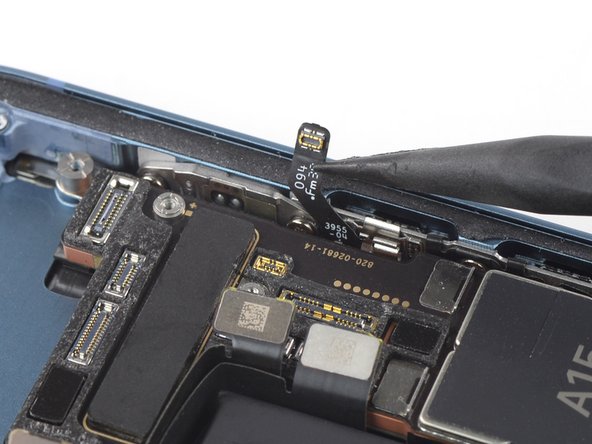

    1. iPhone 14 Logic Board Replacement, Disconnect the power button connector cable: step 52, image 1 of 2 iPhone 14 Logic Board Replacement, Disconnect the power button connector cable: step 52, image 2 of 2
      • Use a spudger to disconnect the power button connector cable by prying the connector straight up from the socket.

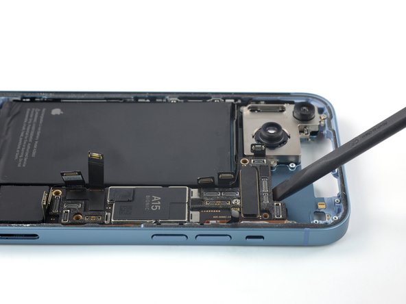

    2. iPhone 14 Logic Board Replacement, Disconnect the rear camera assembly: step 53, image 1 of 3 iPhone 14 Logic Board Replacement, Disconnect the rear camera assembly: step 53, image 2 of 3 iPhone 14 Logic Board Replacement, Disconnect the rear camera assembly: step 53, image 3 of 3
      • Use a spudger to disconnect the two rear camera cables by prying the connectors straight up from their sockets.

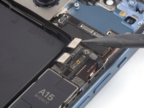

    3. iPhone 14 Logic Board Replacement, Disconnect the volume buttons connector cable: step 54, image 1 of 2 iPhone 14 Logic Board Replacement, Disconnect the volume buttons connector cable: step 54, image 2 of 2
      • Use a spudger to disconnect the volume buttons connector cable by prying the connector straight up from the socket.

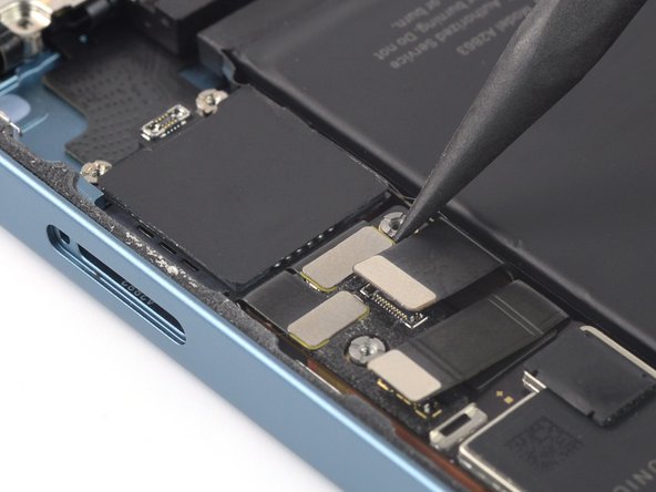

    4. iPhone 14 Logic Board Replacement, Disconnect the SIM card reader and Taptic Engine cable: step 55, image 1 of 2 iPhone 14 Logic Board Replacement, Disconnect the SIM card reader and Taptic Engine cable: step 55, image 2 of 2
      • Use a spudger to disconnect the SIM card reader and Taptic Engine cable by prying the connector straight up from the socket.

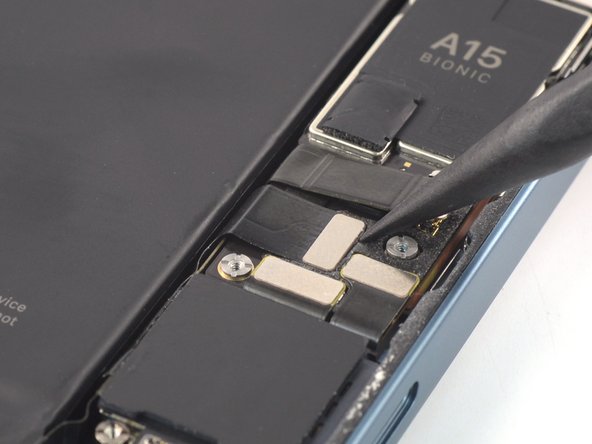

    5. iPhone 14 Logic Board Replacement, Disconnect the lightning connector assembly cables: step 56, image 1 of 3 iPhone 14 Logic Board Replacement, Disconnect the lightning connector assembly cables: step 56, image 2 of 3 iPhone 14 Logic Board Replacement, Disconnect the lightning connector assembly cables: step 56, image 3 of 3
      • Use a spudger to disconnect the lightning connector assembly cables by prying the connectors straight up from their sockets.
