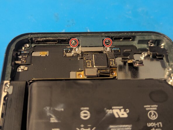

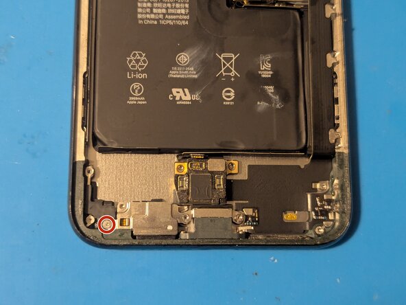

    1. iPhone 11 Pro Max Lightning Connector Assembly Replacement, Unscrew the flex cable bracket: step 31, image 1 of 2 iPhone 11 Pro Max Lightning Connector Assembly Replacement, Unscrew the flex cable bracket: step 31, image 2 of 2
      • Use a Y000 driver to remove the three 1.3 mm screws securing the Lightning flex cable bracket.
      Ask FixBot
    2. iPhone 11 Pro Max Lightning Connector Assembly Replacement, Remove the flex cable bracket: step 32, image 1 of 1
      • Remove the flex cable bracket.
      Ask FixBot

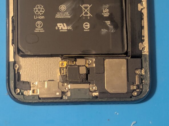

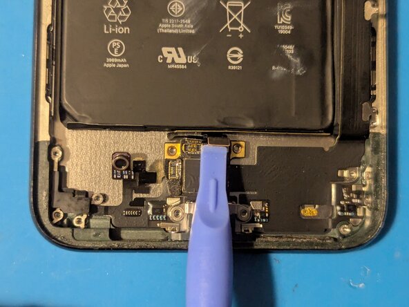

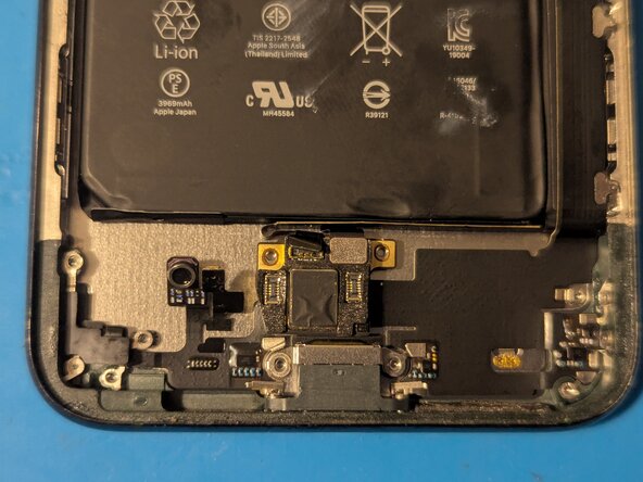

    3. iPhone 11 Pro Max Lightning Connector Assembly Replacement, Disconnect the Lightning flex cable: step 33, image 1 of 3 iPhone 11 Pro Max Lightning Connector Assembly Replacement, Disconnect the Lightning flex cable: step 33, image 2 of 3 iPhone 11 Pro Max Lightning Connector Assembly Replacement, Disconnect the Lightning flex cable: step 33, image 3 of 3
      • Pry up to disconnect both of the Lightning flex cable connectors from the Logic board.
      Ask FixBot

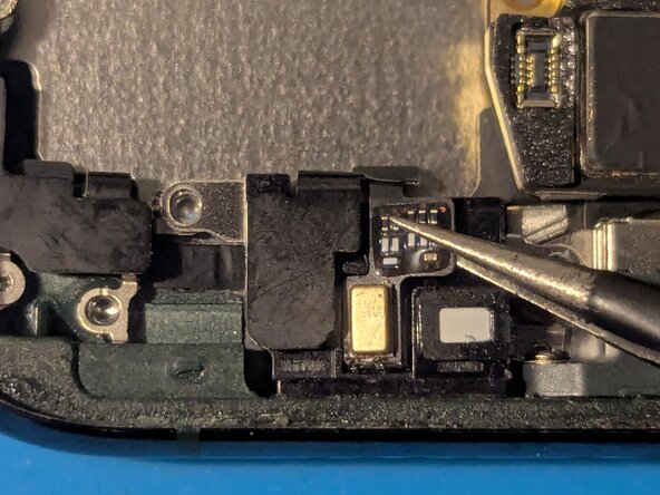

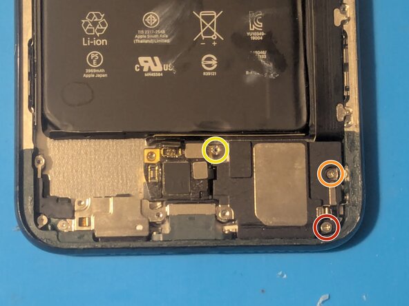

    4. iPhone 11 Pro Max Lightning Connector Assembly Replacement, Unscrew the loudspeaker: step 34, image 1 of 2 iPhone 11 Pro Max Lightning Connector Assembly Replacement, Unscrew the loudspeaker: step 34, image 2 of 2
      • Use a Phillips 000 screwdriver to remove the 2.8 mm screw.
      • Use a Phillips 000 screwdriver to remove the 1.4 mm screw.
      • Use a standoff screwdriver to remove the 3.8 mm screw.
      Ask FixBot
    5. iPhone 11 Pro Max Lightning Connector Assembly Replacement, Disconnect the loudspeaker: step 35, image 1 of 2 iPhone 11 Pro Max Lightning Connector Assembly Replacement, Disconnect the loudspeaker: step 35, image 2 of 2
      • Use a small spudger to disconnect the loudspeaker connector.
      Ask FixBot
    6. iPhone 11 Pro Max Lightning Connector Assembly Replacement, Heat the speaker gasket: step 36, image 1 of 1
      • Use a hair dryer or an iOpener to heat the gasket between the speaker and the frame.

    7. iPhone 11 Pro Max Lightning Connector Assembly Replacement, Remove the loudspeaker: step 37, image 1 of 3 iPhone 11 Pro Max Lightning Connector Assembly Replacement, Remove the loudspeaker: step 37, image 2 of 3 iPhone 11 Pro Max Lightning Connector Assembly Replacement, Remove the loudspeaker: step 37, image 3 of 3
      • Lift the speaker high enough to clear the battery.
      • Rock the speaker from side to side, then pull it away from the frame from one side.

    12. iPhone 11 Pro Max Lightning Connector Assembly Replacement: step 42, image 1 of 2 iPhone 11 Pro Max Lightning Connector Assembly Replacement: step 42, image 2 of 2
      • Use a standoff screwdriver to remove the two 2.8 mm screws on the lightning connector.
      • Use a standoff screwdriver to remove the 2.3 mm screw on the barometric sensor/microphone housing.

    14. iPhone 11 Pro Max Lightning Connector Assembly Replacement, Dismount the barometric sensor and microphone: step 44, image 1 of 3 iPhone 11 Pro Max Lightning Connector Assembly Replacement, Dismount the barometric sensor and microphone: step 44, image 2 of 3 iPhone 11 Pro Max Lightning Connector Assembly Replacement, Dismount the barometric sensor and microphone: step 44, image 3 of 3
      • Use fine tip tweezers to pry the microphone loose from the housing.
      • Fold the microphone and sensor back away from the housing.
      • The barometric sensor is not glued in; it simply lifts out.

    17. iPhone 11 Pro Max Lightning Connector Assembly Replacement, Remove the Lightning connector screws: step 47, image 1 of 2 iPhone 11 Pro Max Lightning Connector Assembly Replacement, Remove the Lightning connector screws: step 47, image 2 of 2
      • Use a Y000 driver to remove this 1.0 mm screw.

    18. iPhone 11 Pro Max Lightning Connector Assembly Replacement: step 48, image 1 of 2 iPhone 11 Pro Max Lightning Connector Assembly Replacement: step 48, image 2 of 2
      • Use a Y000 driver to remove the two 1.0 mm grounding screws on the side.

    22. iPhone 11 Pro Max Lightning Connector Assembly Replacement, Remove the Lightning connector assembly: step 52, image 1 of 3 iPhone 11 Pro Max Lightning Connector Assembly Replacement, Remove the Lightning connector assembly: step 52, image 2 of 3 iPhone 11 Pro Max Lightning Connector Assembly Replacement, Remove the Lightning connector assembly: step 52, image 3 of 3
      • Starting at the corner where the ribbon cable leads to the motherboard, insert a spudger and separate the flex cable from the frame.
      Ask FixBot
    23. iPhone 11 Pro Max Lightning Connector Assembly Replacement: step 53, image 1 of 2 iPhone 11 Pro Max Lightning Connector Assembly Replacement: step 53, image 2 of 2
      • Use blunt nose tweezers to gasp the Lightning connector and rock it from side to side to loosen it, then remove it from the frame.

    24. iPhone 11 Pro Max Lightning Connector Assembly Replacement: step 54, image 1 of 1
      • The Lightning connector assembly has been removed.
      • Carefully compare the replacement assembly to the original. Transfer any parts necessary from the old to the new, such as the foam around the connectors. Duplicate the folds for the microphone and the lead to the motherboard on the replacement as well.
