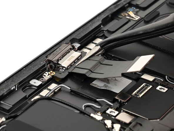

    1. iPad Pro 13" USB-C Charging Port Replacement, Remove the USB-C port screws: step 28, image 1 of 1
      • Use a JCIS or JIS 00 screwdriver to remove the three screws securing the USB-C charging port:
      • Two 2.0 mm‑long screws securing the port to the frame of the iPad
      • One 1.4 mm‑long screw securing the ribbon cable to the iPad
      Ask FixBot
    2. iPad Pro 13" USB-C Charging Port Replacement, Disconnect the USB-C port: step 29, image 1 of 2 iPad Pro 13" USB-C Charging Port Replacement, Disconnect the USB-C port: step 29, image 2 of 2
      • Use the tip of a spudger to disconnect the USB-C charging point press connector.
      Ask FixBot
    3. iPad Pro 13" USB-C Charging Port Replacement, Peel up the USB-C cable: step 30, image 1 of 2 iPad Pro 13" USB-C Charging Port Replacement, Peel up the USB-C cable: step 30, image 2 of 2
      • Slide an opening pick under the USB-C charging point ribbon cable and peel the cable up.
      Ask FixBot
    4. iPad Pro 13" USB-C Charging Port Replacement, Remove the USB-C port: step 31, image 1 of 2 iPad Pro 13" USB-C Charging Port Replacement, Remove the USB-C port: step 31, image 2 of 2
      • Use tweezers to pull the USB-C charging port away from frame, towards the center of the iPad, and remove it.
      • Note that the port is adhered to the frame, so some force is required.
      • On models without cellular, there is a black coaxial cable running over the port's cable. Slide the USB‑C port underneath the coaxial cable to remove it.
      Ask FixBot
