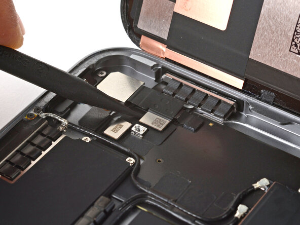

    2. iPad Air 6 11" Rear Camera Replacement, Remove the rear camera: step 15, image 1 of 2 iPad Air 6 11" Rear Camera Replacement, Remove the rear camera: step 15, image 2 of 2
      • Use the point of a spudger or a clean fingernail to pry up and disconnect the rear camera connector.
      • To re-attach press connectors like this one, carefully align and press down on one side until it clicks into place, then repeat on the other side. Don't press down in the middle. If the connector is misaligned, the pins can bend, causing permanent damage.
