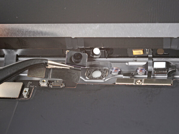

    1. iPad Air 6 11" Front Camera Replacement, Remove the front camera: step 14, image 1 of 2 iPad Air 6 11" Front Camera Replacement, Remove the front camera: step 14, image 2 of 2
      • Use the point of a spudger to pry up and disconnect the front camera connector.
      Ask FixBot

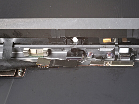

    2. iPad Air 6 11" Front Camera Replacement: step 15, image 1 of 2 iPad Air 6 11" Front Camera Replacement: step 15, image 2 of 2
      Tool used on this step:
      Tesa 61395 Tape
      $2.95
      Buy
      • Use the point of a spudger to pry up the front camera.
      • Remove the front camera.
      • During reassembly, clean off any adhesive residue, then use double-sided tape to secure the camera to the frame.
