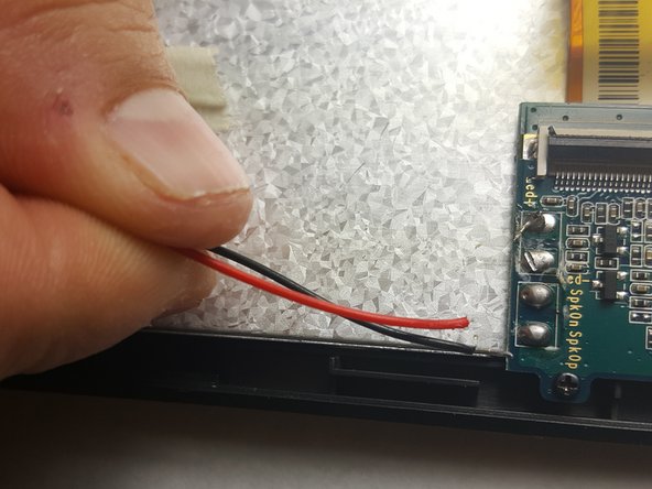

    1. iNet M1001 Motherboard Replacement, Motherboard: step 3, image 1 of 3 iNet M1001 Motherboard Replacement, Motherboard: step 3, image 2 of 3 iNet M1001 Motherboard Replacement, Motherboard: step 3, image 3 of 3
      • Desolder the black and red wires and pull them off of the motherboard.
      • Check out this awesome guide for tips on soldering and desoldering.

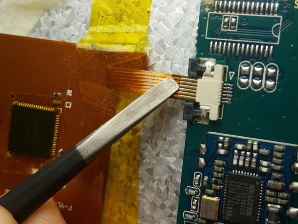

    5. iNet M1001 Motherboard Replacement: step 7, image 1 of 3 iNet M1001 Motherboard Replacement: step 7, image 2 of 3 iNet M1001 Motherboard Replacement: step 7, image 3 of 3
      • Lift up the zero insertion force clip with a plastic opening tool and pull out the ribbon cable.
