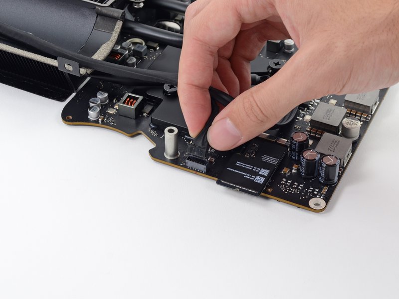

    3. iMac Intel 27" EMC 2639 SATA Cable Replacement: step 29, image 1 of 3 iMac Intel 27" EMC 2639 SATA Cable Replacement: step 29, image 2 of 3 iMac Intel 27" EMC 2639 SATA Cable Replacement: step 29, image 3 of 3
      • Be careful not to touch any solder joints on the back of the power supply. Capacitors may be charged enough to give you a dangerous shock.
      • Use a spudger to disconnect the power button connector from its socket on the logic board.
      Ask FixBot

    1. iMac Intel 27" EMC 2639 SATA Cable Replacement, SATA Cable: step 58, image 1 of 3 iMac Intel 27" EMC 2639 SATA Cable Replacement, SATA Cable: step 58, image 2 of 3 iMac Intel 27" EMC 2639 SATA Cable Replacement, SATA Cable: step 58, image 3 of 3
      • Pull up on the SATA power cable connector to disconnect it.
      • Unplug the SATA data cable connector by depressing its locking tab and pulling straight up on the connector.
      • Remove the SATA cable from the logic board assembly to get it out of the way and prevent it from being damaged.
      Ask FixBot
