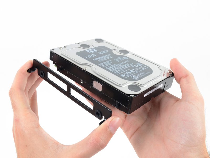

    6. iMac Intel 27" EMC 2546 Hard Drive Replacement: step 30, image 1 of 2 iMac Intel 27" EMC 2546 Hard Drive Replacement: step 30, image 2 of 2
      • Remove the left hard drive bracket.
      Ask FixBot
    1. iMac Intel 27" EMC 2546 Hard Drive Replacement, Hard Drive: step 31, image 1 of 1
      • Remove the four 8.1 mm T8 screw posts from the hard drive, and transfer them to the replacement drive enclosure.
      Ask FixBot

      • Use a T8 driver to install the mounting pins from the old hard drive onto the sides of the enclosure.
      Ask FixBot
    6. iMac Intel 27" EMC 2546 Hard Drive Replacement: step 37, image 1 of 2 iMac Intel 27" EMC 2546 Hard Drive Replacement: step 37, image 2 of 2
      • Attach any mounting brackets removed from the old hard drive onto the enclosure.
      Ask FixBot
