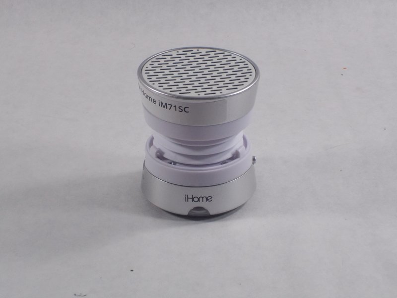

This guide will instruct you in replacing the internal spring of the speaker.
    1. iHome iM71SC Spring Replacement, iHome iM71SC Disassembly: step 1, image 1 of 1
      • Push down and turn the top of the speaker clockwise. This will release the clips and expand the speaker.
