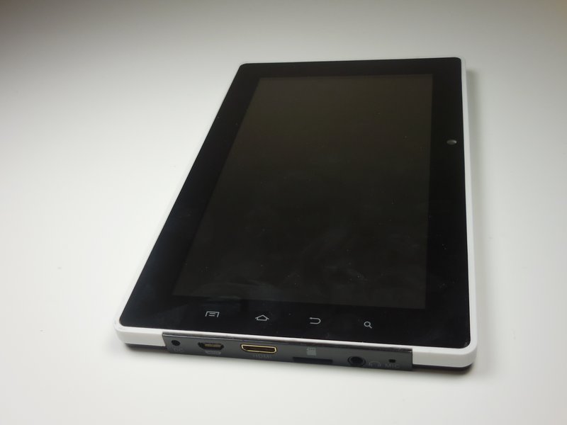

This guide will include disassembling the CT702 tablet and partially removing the motherboard from the device.
Tools
    1. iDea USA CT702 Speaker  Replacement, Speaker: step 1, image 1 of 3 iDea USA CT702 Speaker  Replacement, Speaker: step 1, image 2 of 3 iDea USA CT702 Speaker  Replacement, Speaker: step 1, image 3 of 3
      • Place the tablet on a table with the portholes facing you.
      • Use fingernail or plastic opening tool to gently pry the black panel around the portholes.
      • Be gentle and take your time.
