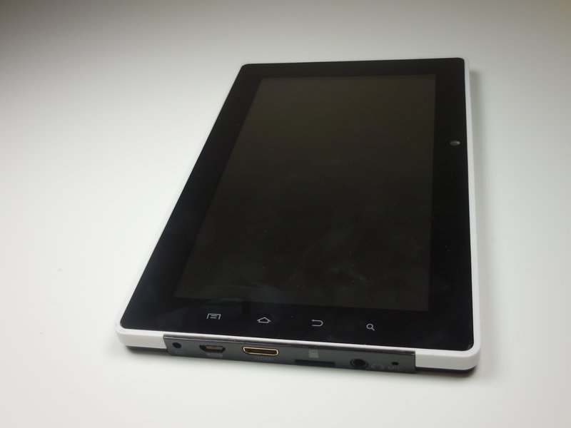

This simple task of replacing the battery will lengthen the lifespan of the charge on the iDeaUSA CT702.
Parts
Tools
    1. iDea USA CT702 Battery Replacement, Battery: step 1, image 1 of 1
      • Face the tablet with portholes facing you.
      Ask FixBot
    2. iDea USA CT702 Battery Replacement: step 2, image 1 of 1
      • Use a fingernail or a plastic opening tool to gently pry the black panel around the portholes.
      • Be gentle and take your time.
      Ask FixBot
    3. iDea USA CT702 Battery Replacement: step 3, image 1 of 3 iDea USA CT702 Battery Replacement: step 3, image 2 of 3 iDea USA CT702 Battery Replacement: step 3, image 3 of 3
      • Use your fingers to remove the rest of the back. Slowly apply pressure from each side to detach each clip connection.
      Ask FixBot
    4. iDea USA CT702 Battery Replacement: step 4, image 1 of 2 iDea USA CT702 Battery Replacement: step 4, image 2 of 2
      • Separate the battery from the device.
      • Slowly use your thumb and forefingers to pry open each corner.
      • Be aware of the adhesive on the bottom of the battery. Remove with care to keep battery intact.
      Ask FixBot
    5. iDea USA CT702 Battery Replacement: step 5, image 1 of 1
      • Carefully peel off tape around the top of the battery.
      • Slowly use your fingernail to lift the tape off of the battery. Dispose of the tape or save it for reuse.
      Ask FixBot
    6. iDea USA CT702 Battery Replacement: step 6, image 1 of 3 iDea USA CT702 Battery Replacement: step 6, image 2 of 3 iDea USA CT702 Battery Replacement: step 6, image 3 of 3
      • Disconnect the battery using the soldering iron.
      • Remember to use proper safety precautions when soldering. Solder from the side and do not breathe the smoke in.
      • Make sure the soldering iron is on the highest heat for 5 minutes before starting.
      • Start with the red wire, and gently touch the tip of the iron onto the connection.
      • Move to the yellow wire after the red.
      • Move to the black wire after the yellow.
      Ask FixBot
    7. iDea USA CT702 Battery Replacement: step 7, image 1 of 1
      • Remove the battery completely. Dispose of the defective battery properly at a recycling center.
      Ask FixBot
    8. iDea USA CT702 Battery Replacement: step 8, image 1 of 1
      • Put the new battery in place
      • Make sure the corners are inside of the white shell.
      Ask FixBot
    9. iDea USA CT702 Battery Replacement: step 9, image 1 of 2 iDea USA CT702 Battery Replacement: step 9, image 2 of 2
      • Solder the new battery.
      • Start with the black wire and solder to the nearest connection.
      • Move to the yellow wire and solder to the middle connection.
      • End with the red wire and solder to the farthest connection away.
      Ask FixBot
    10. iDea USA CT702 Battery Replacement: step 10, image 1 of 2 iDea USA CT702 Battery Replacement: step 10, image 2 of 2
      • Re-tape the battery at the top.
      • Make sure the solder has cooled before taping.
      • Tape the corners in place, onto the shell.
      • To replace back cover, follow the first three steps in reverse order.
      Ask FixBot
To reassemble your device, Start from step 9 and work backwards.
