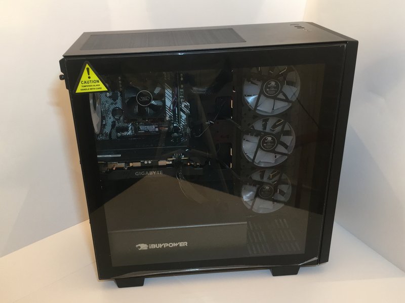

This guide will show you the steps on how to replace your M.2 NVMe Drive in your iBUYPOWER Trace 4 9310 desktop. The iBUYPOWER Trace 4 9310 comes with 2 SATA ports and 1 M.2 NVMe Drive port.
This guide can be completed within a few minutes, and you only need a small Phillips head screwdriver.
As a precaution, unplug and turn off your computer before working on it.
    1. iBUYPOWER Trace 4 9310 M.2 NVMe Drive Replacement, M.2 NVMe Drive: step 1, image 1 of 2 iBUYPOWER Trace 4 9310 M.2 NVMe Drive Replacement, M.2 NVMe Drive: step 1, image 2 of 2
      • Lay the desktop on its side with the glass panel facing up.
      • Remove the single screw.
