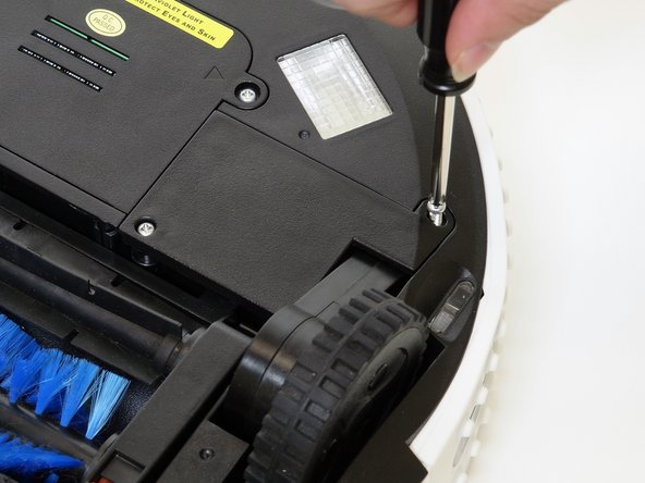

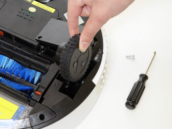

      • Remove bObi’s front wheel to access one of the screws holding bObi together.
      • Make sure the wheel is turned closer to bObi's front touch sensors. Use your screwdriver for leverage, and the wheel will pop up and out.
      • Uninstall the larger screw that sits deeper in the wheel compartment.
