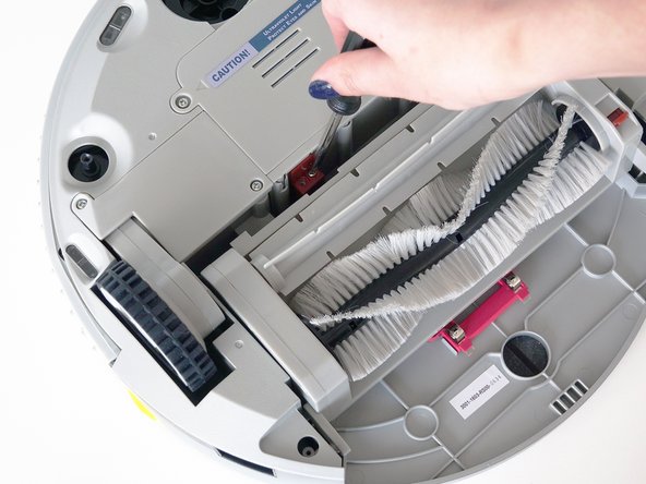

    5. bObi Pet Left or Right Wheel Replacement, Uninstall the Cover Screws: step 5, image 1 of 3 bObi Pet Left or Right Wheel Replacement, Uninstall the Cover Screws: step 5, image 2 of 3 bObi Pet Left or Right Wheel Replacement, Uninstall the Cover Screws: step 5, image 3 of 3
      • Remove the 4 screws located beneath the brush compartment.
      • Next, remove the 2 screws on the dustbin’s red fastener.
      • Remove the fastener and set it aside for reassembly.
