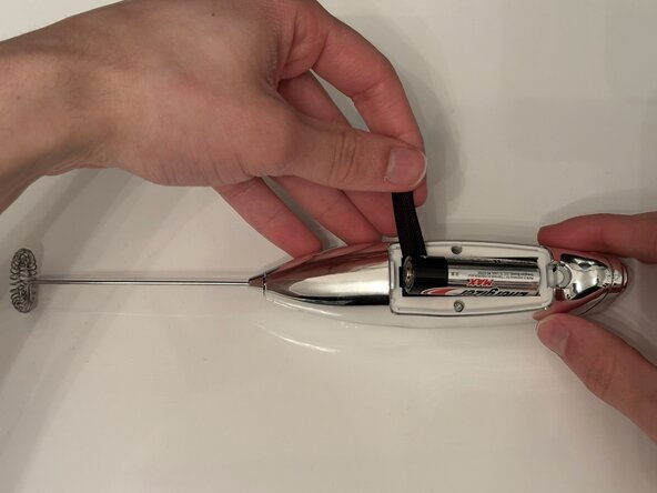

    • Pull and lift the small tab at the bottom of the battery cover to remove the cover.
    • Pull and lift the black tab inside the battery compartment to lift out both AA batteries.
    • Look inside the battery compartment for corrosion before continuing. Corrosion can cause burns and may further damage the device.

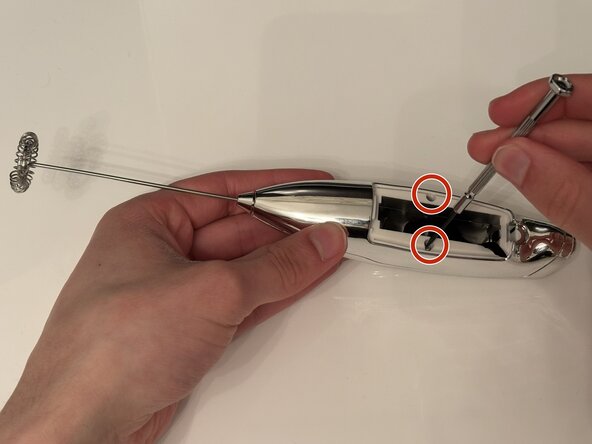

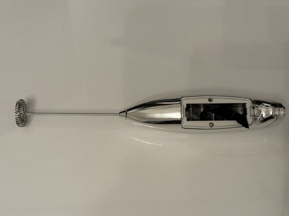

    • Use a Phillips #00 screwdriver to remove the two 12.7 mm screws on the left and right sides of the battery compartment.

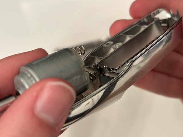

    • Use tweezers to lift the two metal coils from the top and bottom motor terminals.
    • Carefully hold the coils with the tweezers, avoiding the metal body of the motor.
  5. Zulay Kitchen Milk Frother 12V DC Motor Replacement: step 5, image 1 of 1
    • Carefully lift the motor out of the casing using the tweezers at the point where the top of the motor meets the metal rod.
