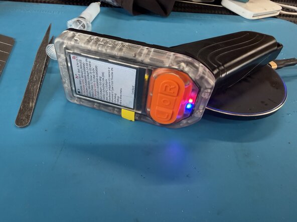

Follow this guide to open you remote up and perform basic repairs.
Several problems can be fixed and improvements made to the remote.
  • Improve button presses
  • Improve range by relocating antenna (older remotes)
  • Fix wireless charging
  • Loose vibration motor
    1. Zerotow Remote, Remove screws: step 1, image 1 of 2 Zerotow Remote, Remove screws: step 1, image 2 of 2
      • Remove the screws from the perimeter of the remote.
      • Remove the Screws under the buttons first
      Ask FixBot
    2. Zerotow Remote, Seperate the top cover from the handle assembly: step 2, image 1 of 3 Zerotow Remote, Seperate the top cover from the handle assembly: step 2, image 2 of 3 Zerotow Remote, Seperate the top cover from the handle assembly: step 2, image 3 of 3
      • Use a knife blade or thin scraper to gently separate the cover from the handle assembly.
      • Work slowly around the perimeter until the the cover is free
      • The cables that connect the top cover to the handle are very short. do separate with uncontrolled force otherwise you will break the cables.
      Ask FixBot
    3. Zerotow Remote, Remove battery connector: step 3, image 1 of 3 Zerotow Remote, Remove battery connector: step 3, image 2 of 3 Zerotow Remote, Remove battery connector: step 3, image 3 of 3
      • Gently lift the bottom of the cover
      • With tweezers remove the power plug to the remote. This has the red and black wires to it.
      Ask FixBot
    4. Zerotow Remote, Remove the wireless charger connector: step 4, image 1 of 2 Zerotow Remote, Remove the wireless charger connector: step 4, image 2 of 2
      • Use tweezers to remove the wireless charger connector. This is a USB micro connector and is very fragile.
      Ask FixBot
    5. Zerotow Remote, Opening.: step 5, image 1 of 2 Zerotow Remote, Opening.: step 5, image 2 of 2
      • The screen can now be opened as shown
      Ask FixBot
    6. Zerotow Remote, Reassembly: step 6, image 1 of 1
      • Use a syringe with a blunt tip to apply a thin bead of silicone grease to O-ring on the screen.
      • If you do not have a syringe you can use tooth pick or the tweezers to apply the grease.
      • Alternatively you can apply the grease to the handle side of the the remote
      Ask FixBot
    7. Zerotow Remote, Reassembly - Connectors: step 7, image 1 of 2 Zerotow Remote, Reassembly - Connectors: step 7, image 2 of 2
      • Connect the cables as shown
      • On the handle side align the power and charging cables to be as close as possible to their sockets
      • Close the lid and use the tweezer to plug in the power cable first, and then the USB
      • The USB is quite tricky to get in, take your time.
      Ask FixBot
    8. Zerotow Remote, Pinched cables: step 8, image 1 of 1
      • Once everything is connected, lift up each side of the screen to make sure no cables are going to be pinched.
      • Use tweezers to rearrange the cables if any look like they will be pinched
      Ask FixBot
    9. Zerotow Remote, Check functionality: step 9, image 1 of 1
      • Check all of the remote functionality before screwing it together
      • Wireless charging - Blue light turns on when on the charger
      • Throttle works and calibrates
      • Remote GPS works - leave outside for 10 mins and you should see 10+ satellites.
      • Range check to Boogie - greater than 25 meters
      Ask FixBot
    10. Zerotow Remote, Screw together the cover to the handle: step 10, image 1 of 1
      • Check again for no pinched cables
      • Start with the underside screws first, then the two on the front
      • Loosly tighten all the screws in the remote
      • work your way around the remote, tighten the screws a little bit more each time. Do not apply too much force as the screws can strip out the plastic easily.
      Ask FixBot
      • Submerge the remote in FRESH water for 30 mins to ensure there is no leaks before use in salt water.
